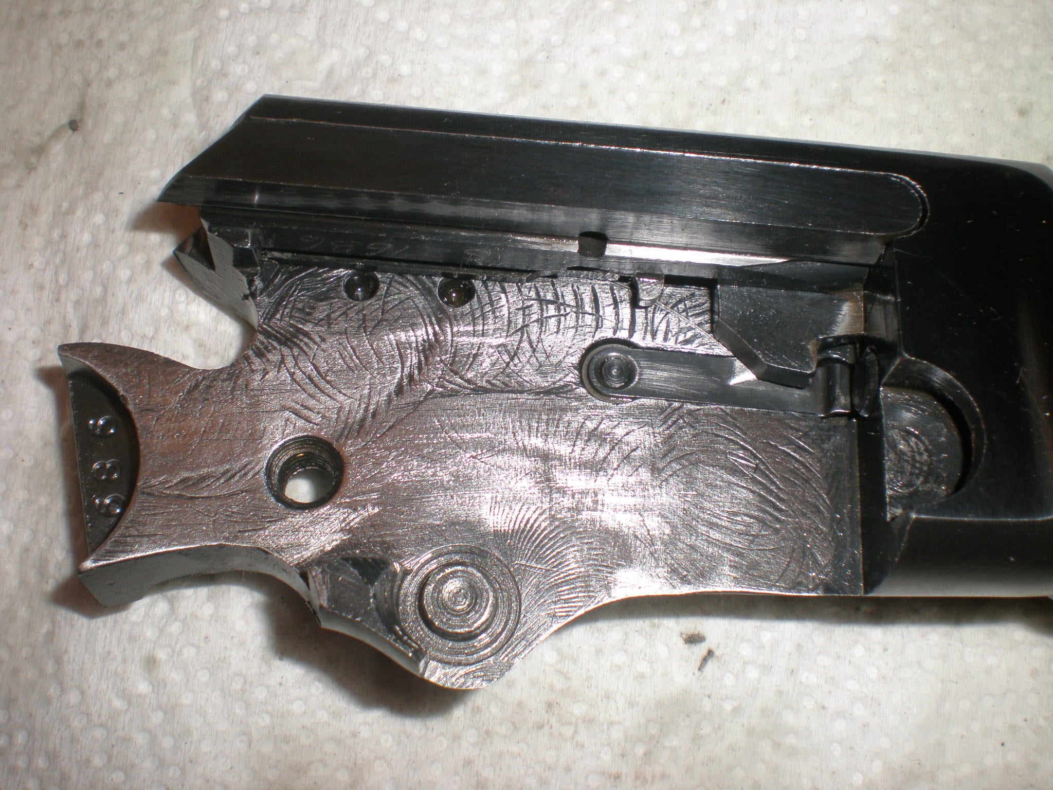

One of my clients has begun letting me work on his collection. So far I did his old Browning Belgium and his old Colt New Service. This weekend I worked on his old Golden. It failed to eject and the action was very stiff. Like so many of my projects the problem was decades of abuse and poor cleaning. I took it completely down and began cleaning and then sanding/polishing the internal frame and polishing the action parts. It now runs like a champ will do a range test later this week.
Oh yes it is that filthy - took all the parts out / then sanded down the inner front and rear frame - with 600 grit them followed with 2000 grit sand paper. Cleaned and polished the internals - then soaked everything overnight in Breakfree.

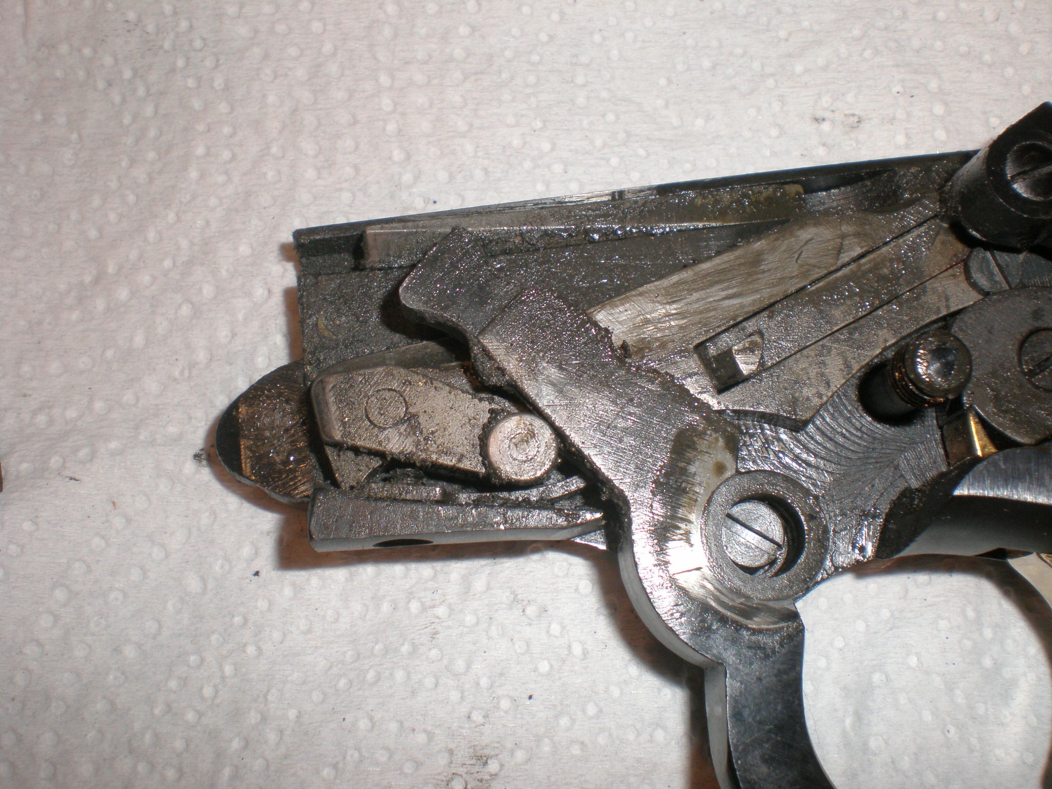

The ejector is under the bolt - that area was deep in old crud and the ejector arm wouldn't move. More crud. I did the sanding/polishing routine on this side and polished the bolt/firing pin etc..
Reassembled the fire control group - looks pretty good ( patting myself on the back )

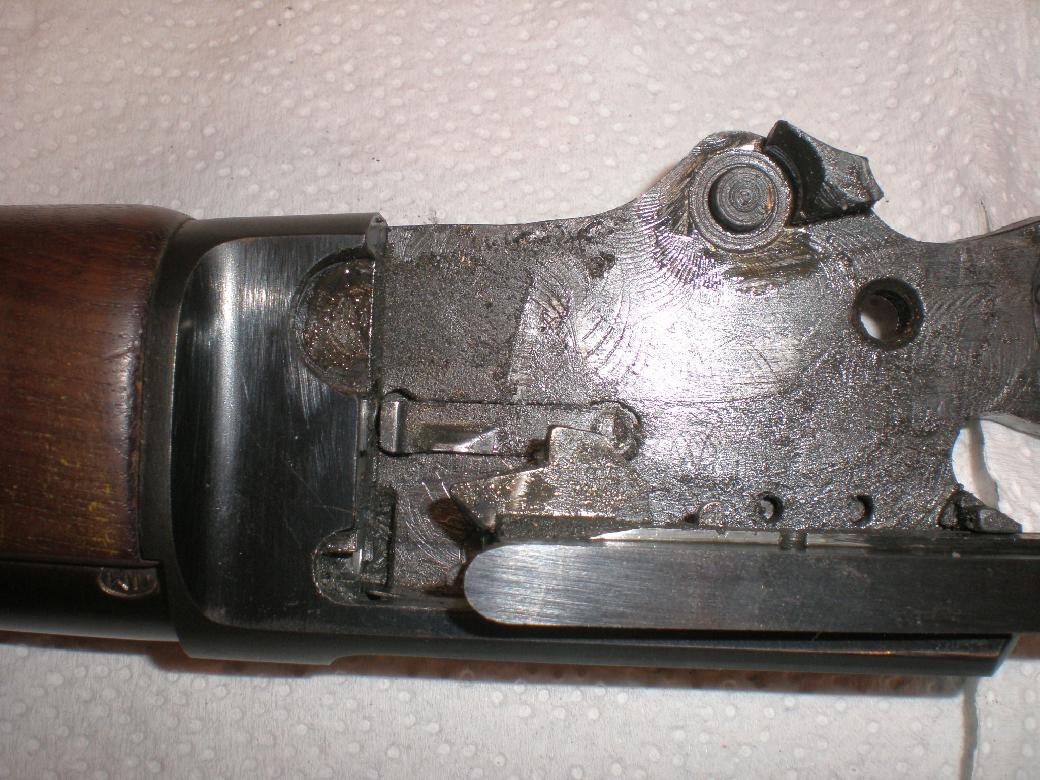

The other side - much cleaner now.

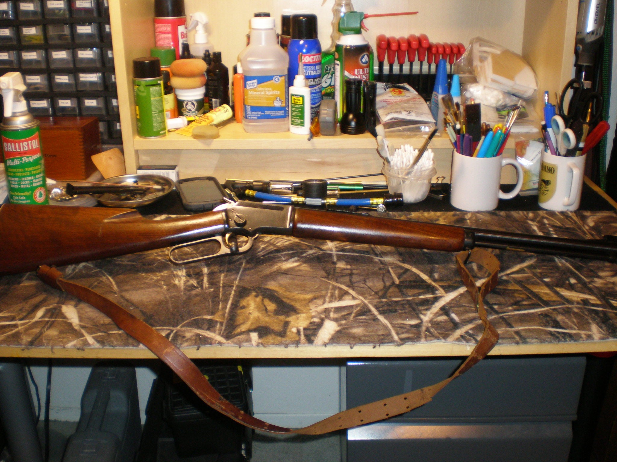

Oiled and rubbed down the stock - now it looks like a Marlin should. I ran about 100 rounds through it with one fail to eject and one slow to eject. So I removed the ejector asm and the extractor for some deep cleaning. Think I will replace the ejector spring as it seems a bit weak. Their was some build up in the extractor channel - cleaned all that out to. This is an amazingly accurate old rifle.
I'm sure this has been discussed somewhere ... Are those unsightly circular marks from the milling machine considered to be normal for these guns? I have to say that they look nasty. Are they " grease reservoirs" or just sloppy machine work? Or is there a valid reason for them, say an aid to getting a precise fit of the two halves, like the "file to fit" ridges on the bottom side of an XS Sights dovetail?

Those are milling marks and yes they can hold crud and cause issues. I sanded them down some - didn;t want to go to far as that might affect the fitting of action parts. After sanding - I followed up with 2000 grit , then a light polishing. That was followed by an overnight soaking in Breakfree CLP.
