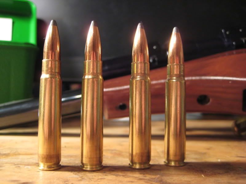

So yeah... I finally got the stuff to load for the rascal. Very interesting and fun stuff. I finally goofed up with my chargemaster combo though, and I forgot to close the drain spout like an idiot and found H322 all over my table, so I had to clean that up.
I started at 24 grains, and worked up in .2 grain increments eventually until I got to 25 grains, maximum being 26. The only time I didn't work up in .2 grains was when I got to 24.4, and went to 24.8 so I could load the last 4 with 25grs. to equal a total number of 20 cartridges. I found myself trying to find powders that wouldn't wind up in a compressed charge, but it seems like 25 is pretty much almost compressed, with the bullet touching the top of the powder. H322 seems very bulky, and a minimal amount of powder equals a very large charge rate, which my scale was on because I checked it, just the nature of the powder.
The bullet in the cartridge on the left is not crooked, just the way the picture looks.
Hopefully these shoot good, and fire in the first place. I've heard these thompson centers can be fussy sometimes. I should have videos and a range report Wednesday. Hope y'all enjoy the vids!

YYYEEEHHHAAAAAA!!!! Shot my pistol today! Dang was that exciting!!! ;D Most loads shot good, but I pulled off on quite a few of them on the last shot which screwed up some of the groups, but I got some promising loads. 24.4 grains shot great, and 24.8 grains put 2 touching, with one through the same hole, and 1 flyer, but the pressure was getting on up there. I'm going to settle on 24.6 grains. The scope is a very low magnification scope and it was hard for me to see the target at 50 yards since it was basically like open sights with crosshairs. I'm going to load up the last 30 rounds I have and take it shooting saturday so I can get all 50 rounds of brass I prepped fire-formed. It's definitely a weird unique looking cartridge now that I have the brass fire-formed and the 30* shoulder is present, and I'll make sure I have video of it saturday. I'll post a pic of the target after I eat. I will say one thing though... I've gotten to work with compressed charges, and I never will again. The 25gr. load was a compressed charge, and it was so hot the groups were horrible, the gun was hard to open, and the recoil hurt my hand and it's hard to believe 26 grains is a maximum load. Isn't it funny how 24.8 shot so great with pressure signs just starting to show, and 2/10's of a grain higher was too much and allowed for a compressed charge. Reloading is so fun, and especially working with my first wild cat! ;D
