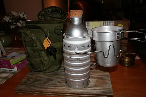

I saw some video of these stoves and they look pretty flexible. Features:
  • They are all aluminum - conducts heat well. Contrary to some rumors, aluminum doesn't cause Alzheimer's diesease.
  • They are about $10 for the flask, cork, cup, & windscreen.
  • They can use twigs for heat (about 8 min to boil a full cup).
  • They can also use small alcohol stoves, Esbit, Sterno, or a Borde unleaded stove (if you can find one).
  • If you get one from CheaperThanDirt.com they have a nice molle bag that just fits as a case ($15)
http://www.cheaperthandirt.com/ItemDetail.aspx?sku=Molle-010

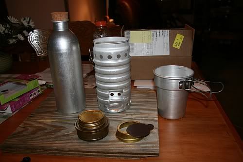

Thought these would make a great little item on a hunt or a hike in case you want a hot drink or a meal. Here is one that I got recently:
Some folks have complained that the cork leaks, but I remember from my wine drinking days that corks need to be wet or they won't seal. So soak the cork for a few minutes before sealing and it works really well.

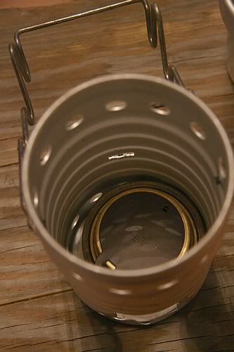

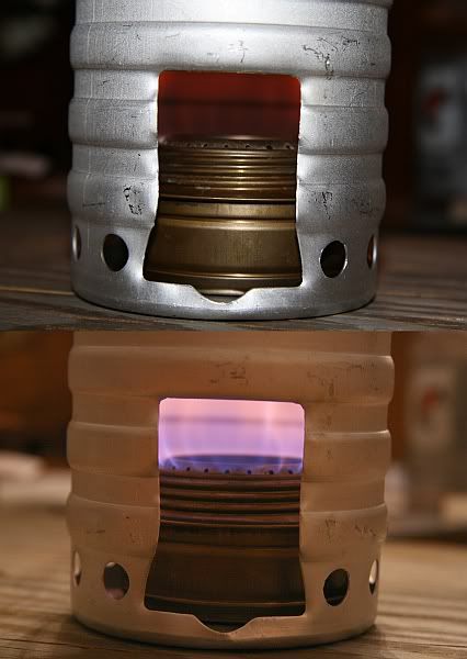

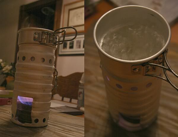

I thought I would try it with a trangia burner. You can get them for around $12-15 if you look for them. They are really amazing! It was hard to get in the windscreen when it is full of fuel because of the tight fit. I let it set for a moment and then used a firesteel to light the vapor in the windscreen.
It was extremely effective!! Boiled a full cup (12-14 oz?) in less than 4 minutes. :eek: Only problem was that to put the fire out you either have to guess well at the amount of fuel or have the simmer ring and carefully drop it on the flame in the hopes of snuffing it out. Since the windscreen gets extremely hot, it takes several minutes to cool down. Then I have to find a way to get it out without spilling the remaining fuel. Not the best system. :-\
I forgot to mention that the bottle can be used to boil also which is great, but there is no way to handle it unless you have some heat-proof gloves. Probably why most of the videos don't show much of this. I have a very small alcohol burner coming that is fairly inexpensive ($20). It is called a Choke Hazard stove. Pretty wild. Got the idea from this very weird video:
