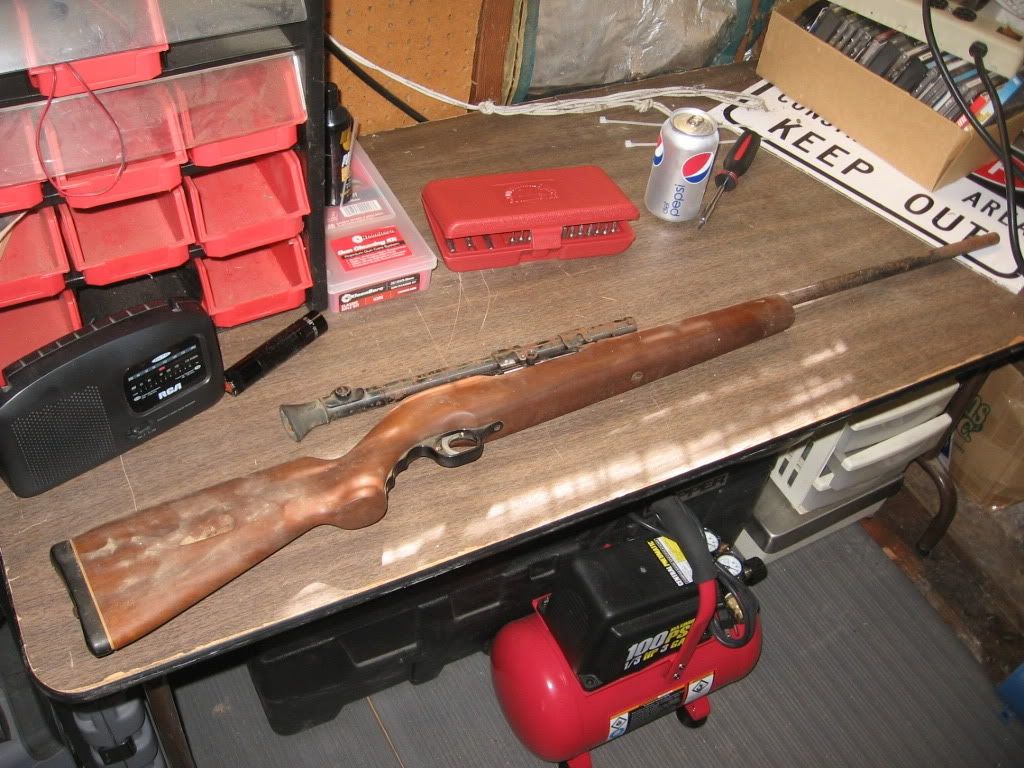

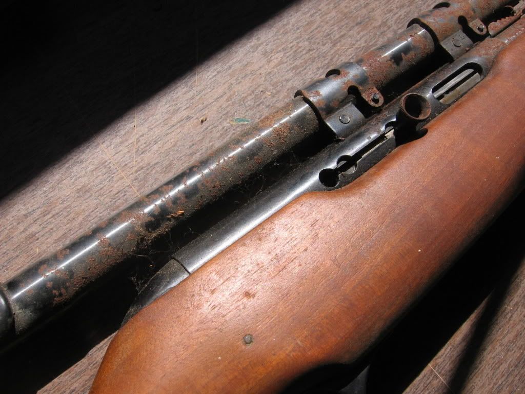

My Dad gave me this gun the other day, it was given to him about 30 years ago, from a friend of his father. I've wanted to restore a gun, so I figure this is the one I'll use. Mechanically, it's in very good shape, but the outside is horrible (been stored in the rafters, un oiled, and forgotten all of those years. Here it is.

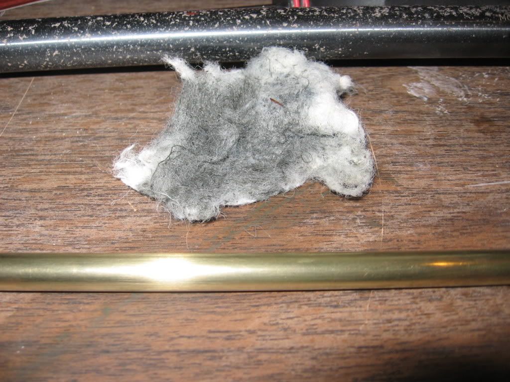

I looked through the gunsmithing section for something on removing rust, and found one member liked Nevr-Dull, so I bought some to try. It didn't work for the barrel, but for the internal magazine tube, it made it gorgeous again:

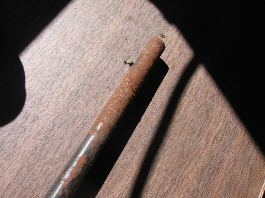

And without any luck from what I had, I decided I'd just reblue the entire thing, so I hit it with some Naval Jelly, but it didn't get the rust, like I was hoping, only the bluing. What should I do to remove it? Here's a picture of how 3/4 of the barrel looks now.

A project indeed :) You going for a original look or a well finished gun. I think you gonna have to eliminate rust pits in the metal to make it worth the effort :)

It's not a rare, or particularly valuable gun, but I would like to make it as close to original as I can. I've been trying to remove the rust and pitting, even hitting it with copious amounts of CLP, and a brass brush, but it's not really making a dent in it. I was going to take the barrel down to the gunshop tomorrow, and see what they advise me to do, but I was hoping somebody on here would have some advice.

I'm guessing you will have to use 400/600 wet or dry or 000 steel wool on the whole barrel. That will change the factory surface. I would go easy over the lettering and be careful not to sand a flat spot on the barrel. As you say it's a project and a shooter. If you rattle can it with paint it will help you see the blems and help you visualize what a blueing will look like and wipe paint off with thinner. Have fun :)

Thanks, I'll have to see if I have any of that handy. I'm guessing I should wetsand it, or use oil?

Little update: I picked up some steel wool today, didn't have much of an affect on the pitting on the barrel, but I think I salvaged the receiver, so I'm happy about that. Tomorrow after work, I'm going to pick up some 400-800 grit paper, see if I can work those imperfections out.
More to update, I'm feeling real confident with this project now! I got some sand paper today, and went in and got the barrel all smoothed out, so it's real nice now. Though I was wondering how the left over "speckling" would affect the bluing, if at all? Since it's completely smooth, I can run my finger nail across it in either direction and not feel any bumps, or get caught.

Yep... #3 or #4 steel wool should clean that up good...Your 90% there I'm thinking :) The letter stamping looks good.
