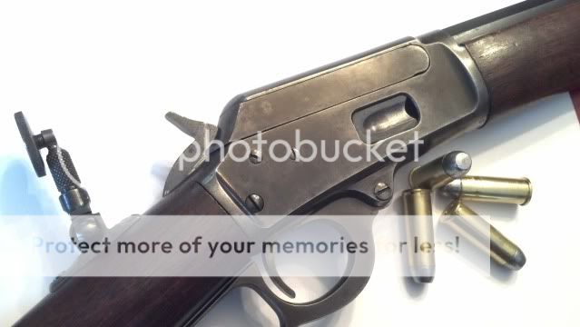

It came yesterday, and I am very pleased. I was prepared for it to be rougher than it is. Now I feel a great deal of pressure to keep it nice, as it was obviously someones beloved family heirloom. Here are some pics. Please tell me whatever comes to your mind as you look.....Thanks, Tom
More....By the way, it has a competition trigger that breaks between 1 and 1 1/2 pounds, and breaks clean. I'm thinking the missing screw in the middle of the tang is where an upright type sight was installed. Remember in Quigley, he took a sight out of his pocket and screwed it onto the rifle?
#22 · (Edited)
Last 4.....I know men were smaller back then, but this rifle is dainty!! It would be just excellent for a lady.
I'll post shooting results when it cools down a little. I don't want to sweat all over it!! Thanks again for looking.
So can any of you collectors tell me what I have got here? Are there any things I should know about cleaning/preserving it? Any issues with older guns that I may not know about? This is my first "old" firearm, and while I like it a lot, I wonder if you guys, looking at the pictures, are seeing anything I don't see. Thanks again. Tom
I see great rifling for a vintage Marlin. The rear sight is incorrect, but will work. Looks to be an older refinish. The only issues I could think of is the bore size. If your buying ammo I would get BP loads with lead bullets. This way the bullet will (hopefully) bump up enough in the barrel to give decent accuracy. When you do finally slug the bore which you should I'm pretty certain the groove size will be larger (possibly much larger) than the .427 bullets loaded in modern ammo today which is for modern 44-40's. You may find something over the counter that shoots decent, but it's undersize bullets will give inconsistent velocities which affects accuracy and barrel cleanings could be frustrating. These old Marlins are best hand loaded for best accuracy. Playing with vintage Marlins is a good learning experience! Let us know if you need help. There's a few good folks here who have these old Marlins figured out! Good luck and shoot straight!
Here's what the correct rear sight and elevator looks like for your rifle. Note the feet on the bottom of the sight.
The two smaller holes on the tang are for a tang sight. Here's a Lyman "E" stamped tang sight on my vintage 44-40 Marlin. Mine is a Model 1894 which is basically what was made when the model 1889 was discontinued. The receiver is pretty much the same, but note the lever latch on yours is external where mine is inside the receiver.
I agree with Lou; it's a nice older restoration. They got most of it right, but like many restorations they left out the casehardening on certain parts. Still a very clean gun, that appears to have been well cared for, and not shot much. Should be an excellent shooting 1889, and give you many years of enjoyment.
