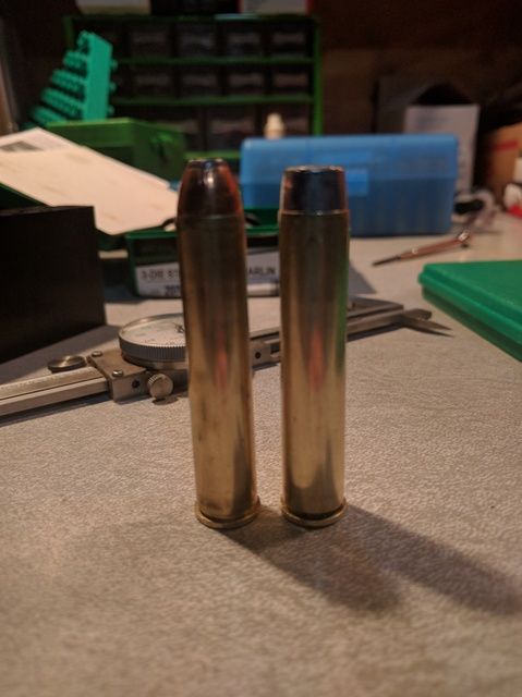

Well i received the Leadheads from Nemo today and i found out what the case over all length is with this bullet in my XLR.Just like Nemo's rifle i could not get this round to feed unless it was at least 2.5 COAL.So now my question is,,,will my RCBS die crimp this bullet where needed or do i need to get a Lee factory crimp die in order to crimp these rounds properly?
Hornady 265 grn on left with a 2.565 length and the deadheads at 2.5 on the right
