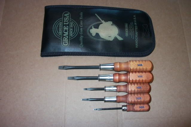

I spoke to Dan Morisson, owner of Grace USA, and he informed me there was a specific set of screwdrivers needed for both the Marlin 1894 and the Marlin 336..I have read threads on this site that stated some Marlin owners weren't too happy with the fit of Grace Marlin specific screwdriver set, and commented that it was a set of common heads thrown together. Dan told me there is a specific set for the 1894, in production now, and he has received specs from Marlin Owners Forum member(s) for the 336 set which is not in production as of yet.
He quoted me $38.00 + $7.50 shipping for the 1894 5 screwdriver set. Any comments? I am new to the forum and just purchased two Marlins, both older JM stamped, 1804CS and 336 30-30. I tried to take the screw holding the lever off in order to field strip and clean the rifle, but it was difficult, even though I was being careful..I noticed the screw heads were thinner and deeper than my screwdriver head.

I too spoke with Dan several years ago and he sent me a Marlin set before I even got a check in the mail. I have used them on all of my Marlins and have found them to be top notch tools. Well worth every penny. I would not hesitate sending business his way because I'm extremely satisfied with the set I received.
1895gunner
+1 on 1895Gunner's comments. I have been very happy with my set. I used to use an el cheapo set that kept breaking off tips. I bought Grace's and have never looked back. Screwdriver set was sent before I even sent them payment. Good people to deal with. Sometimes you do get what you pay for :flute:.

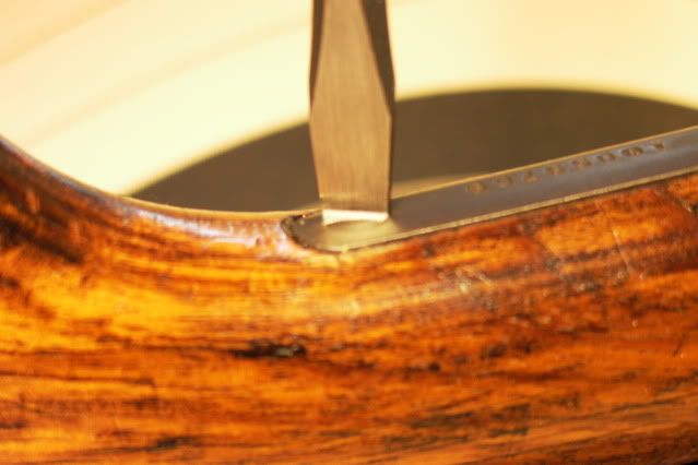

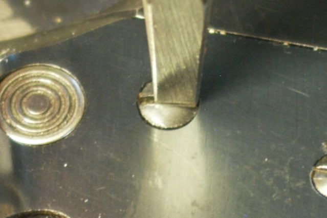

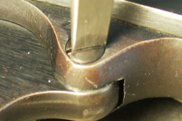

A couple of years ago, I bought a 'Marlin' set of Grace screwdrivers in one of the group buys. I think they were about $20 then. I was unsatisfied with the way they fitted the Marlin screws so I sold them ( I informed the buyer why I was selling them) and got a set from Brownells. The Brownell's set fit the screws correctly and the bits fit in the handle for storage and they were magnetic also.
" Dan told me there is a specific set for the 1894, in production now, and he has received specs from Marlin Owners Forum member(s) for the 336 set which is not in production as of yet." this quote acknowledges to me that previous sets were a collection of the regular screwdrivers with 'Mar' marked on the handles thrown together without reguard to fit.
For a screwdriver to fit properly, it should fit all the way to the bottom of the screw slot, and be as wide as the diameter of the screw slot.
These photos of Grace screwdrivers were included with my previous post informing Marlin Owners of the poor fit of these screwdrivers.
Notice the screwdriver blades were not wide enough to fit the diameter of the screws. You can't fully tighten the screws without damaging them.
Let the buyer BEWARE!
M.

I have all 5 of the screwdriver from Dan Grace. Mine are a perfect fit for all my 336s. They are flawless and if one should break, Grace stands behind them . I also have a set of his drift pins and brass hammer. I have never had a problem with these tools. I got them when Marlin Owens had group purchase. If I recall everything was about $60.

80hp, for a screwdriver to fit the screw, you must put the bit in the screw, not off set to one side to make it look too small and sellect the proper bit for the screw, not a narrow bit for a wide screw.
I don't have an 1894 but I use my Grace Marlin set on pretty much everything from 336's to 1895's to 795's and even non-Marlins. Love em. I also love having the Grace brass hammer and brass punch set. Excellent tools from a great guy. If you have issues with his tools, I'm pretty sure Dan will find a way to make it right. We've had folks report getting replacements years and years after the original purchase.
