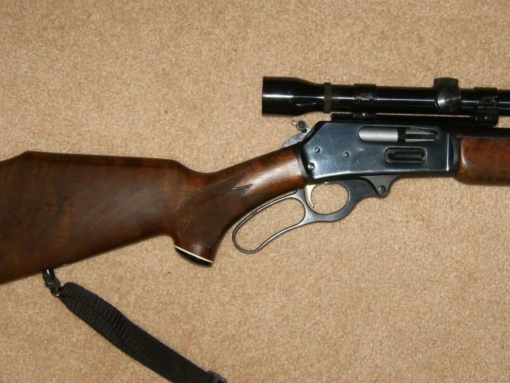

I'm with Tomray on this question, as the two examples of this model I've seen just weren't worth the extra asking in my opinion. If you really want a nice, higher quality Marlin lever; then I suggest you search for an early Model 336A-DL or 336SD. These are great factory made rifles, somewhat rare in some configurations; and will hold their value if properly cared for. My personal preferences are for the examples of the above Models from the 1957-1962 manufacturing period with their special Bishop designed stocks. Presently on Gunbroker is listed a very nice 336SD in 30/30 (the seller has it mistakenly listed as an SC), but good luck if you go with the new Deluxe model; who knows, you may get lucky and get a really good rifle.
It is, thats what i was told on here about a year ago, I know that it is a 336 A.....i was told by others that its a deluxe model b/c of the stocks and checkering....Im only going by what i was told. It was my dads gun he bought years ago for 150 dollars. He ended up selling it. Well i tracked it down and bought it back. That gun has one smooth action compared to my 336 CS
