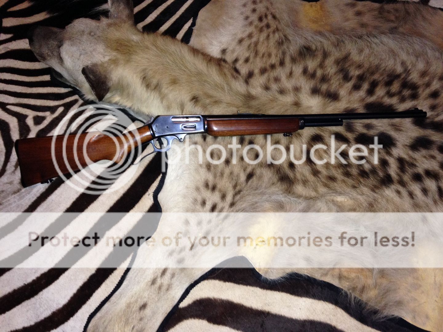

Bought this 1949 Model 94 in 32 Special today at a LGS. It is in great shape to be so old, a few handling marks and blue loss as to be expected. I have 7 old Marlin leverguns, but never liked or wanted a Winchester. Kind of felt un-American not to own at least, one so since they had it in a not so popular caliber and they threw in all the ammo pictured i had to buy it for $500 out the door. It does have a Williams peep site installed and a Pacamayer butt pad, I wish they had left it original. I may put try to get it back to original as possible but for a shooter it is fine. Bore is mirror. Nice old gun! Now I can get back to my Marlin obsession!

I can't imagine better choice for your first Winchester lever. As you can see, several of us have them, including me. I have a Winchester 94 in that chambering as well as a couple Marlins. Since this is a Marlin site, here's a pic of my 1949 Marlin 336A in 32 Special.

I happen to like old Winchesters, and have always had a soft spot for the 32 Winchester Special.
When I was a boy I used one belonging to a great uncle a good bit.
He always swore it was a better killer of deer than the far more common 30-30.
It worked well for him, and for me as well.
Congratulations on a very nice acquisition.
