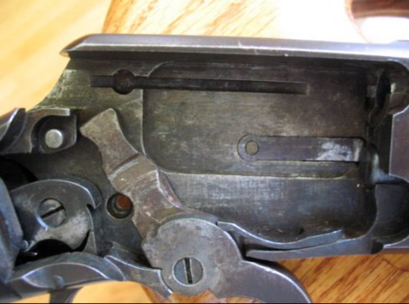

Wait, the magazine cut off is the piece inset into the left side of the receiver in your picture. The empty relief on the left side above the cut off is for the ejector. The cartridge cut off is recessed in the right side removable side plate. This is the picture i received on another forum.
