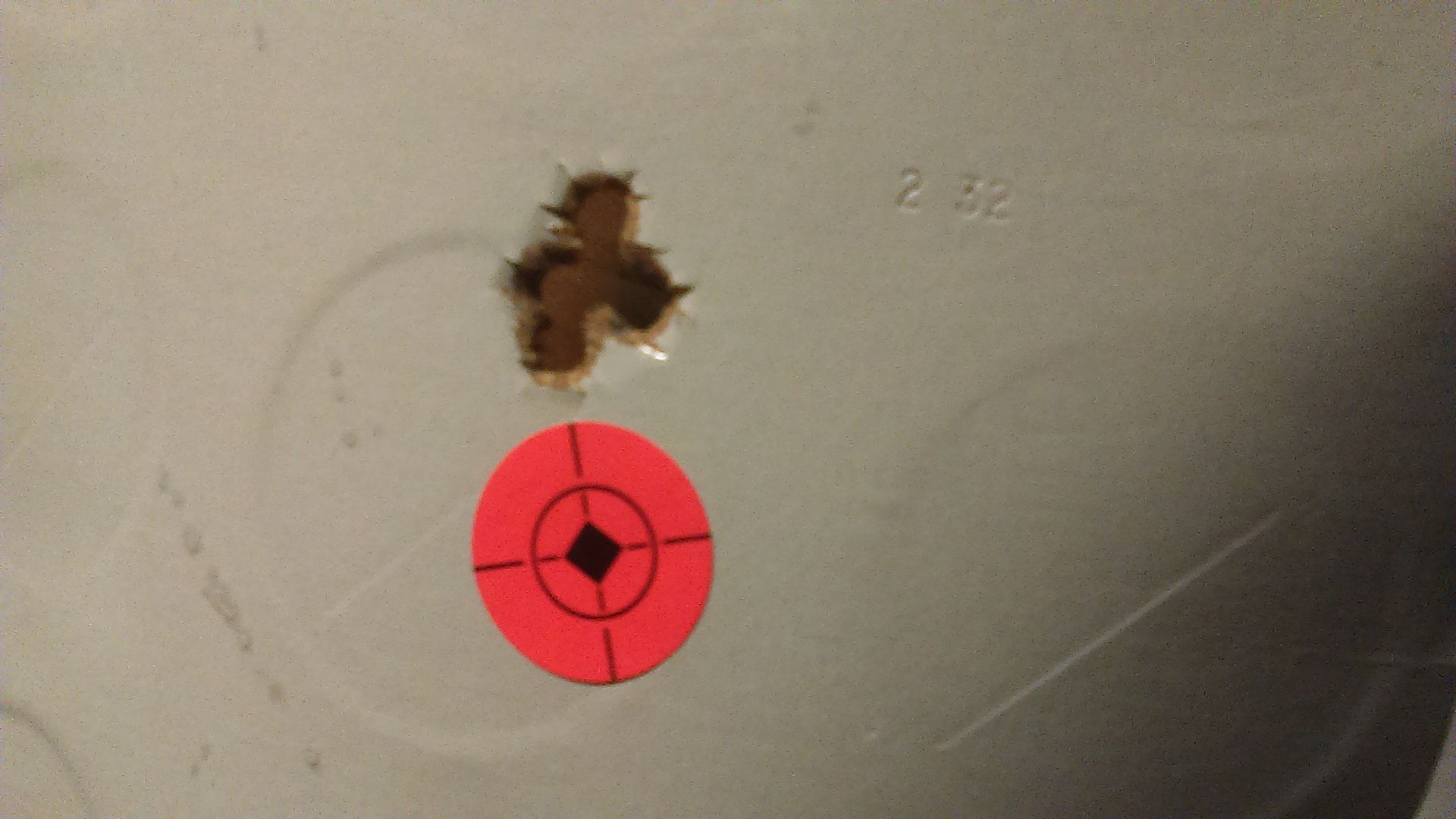

I 100% AGREE w/ the following, about Lil Gun:
1) PapaJohn: (The Guru of The .357 Lil Gun Load)
"Easy metering, consistent results, great load density, and accuracy that makes your nose cool and moist and your coat sleek and glossy. I know folks are getting tired of seeing these groups, but it's why I love this powder in my 1894C.....it will consistently do this with the load I finally settled on, 16.2/Lil Gun/Rem 158. Five shots at fifty yards, rested. If the groups start opening up, it either means I'm getting tired and not focusing properly, the gun is filthy, or both.
This image has been resized. Click this bar to view the full image. The original image is sized 800x450.
I've played with every bullet I could find in the 357, from 88 grains up to 220, and I'm firmly convinced the 158-grainer at about 1700 fps is the best all-around "Utility Load" I'll ever find. It also tends to shoot well from a wide variety of guns, and that combination has been dubbed the "Papajohn Load", meaning it's in the rarefied atmosphere of loads that seems to shoot well in a large percentage of the guns they're fired in."
2) BlackDog: (I Agree & NEED to Try 4227 For Sure)
"I have had the best luck with LilGun, Unique and 4227. LilGun for stout loads, 4227 for medium loads and Unique for lighter loads. I shoot lever action silhouette with my .357 - using 125gr XTP bullet and 6gr of Unique = same point of aim from 40 to 100 meters!
4227 sends the targets flying and is a bit of "overkill."
And, I use LilGun for 158gr XTPs when I use the .357 rifle for the 50/100/150/200 meter targets. 16gr of Lilgun and a 158gr bullet has no problem taking a 200 meter (65 pound) ram. Would be an ideal whitetail load too."
3)UncleSarge58 (My Opinion & Endorsement)
Started Out w/ PapaJohn's Legendary Load, Worked it UP a Lil' & Mine Likes Only 0.5gr More.
(16.7gr & That's Real Damn Close!)
Over 1700fps Too w/ Hornady 158gr XTP-Flat Points (My Meat Doe Load). Knocks 'em DDRT!
Thank You PapaJohn!
