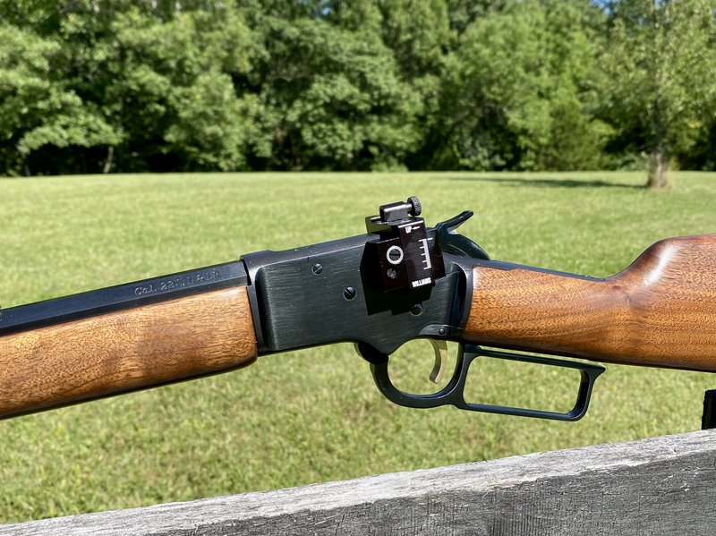

For factory ammunition, Remington .357 Magnum 158 JSP's, when zeroed at 100 yds (with a Williams Foolproof receiver peep mounted and the original front sight), you'll be 1" high at 25 yds, just under 2" high at 50 yds, and dead on at 100. I've chrono'd this load at 1600 fps from my Marlin 1894 CS. It's a killer on deer to ~75-100 yds so sighted. Groups run less than 2" @ 100 yds.
With handloads, using Hornady's 158 XTP Flat Point & 15.0 grains of Winchester 296 with Federal 550 Mag primers, I get 1557 fps (chrono'd) & 1-1/4" 100 yd groups. These were 5-shot group averages with a 2.5x scope mounted. Trajectory varies a bit from the receiver peep...giving me impacts that are 1/2" high at 25 yds, 1.5" high at 50, with a dead on zero at 100. It's really a great deer load for close in (<100 yds), woodland hunting & one that is my go-to for any & all hunting with the Marlin carbine and has done for 3 deer, a cpl of racoons and one horse feeding raiding possum.
HTH's, Rod, Pic of my 1894S in .41 Mag using the same Williams Foolproof receiver peep. 2nd close-up Pic of my Century Limited 39 with another Williams Foolproof mounted, makes for a nice neat sighting arrangement and far better accuracy than the OEM factory rear sight.
