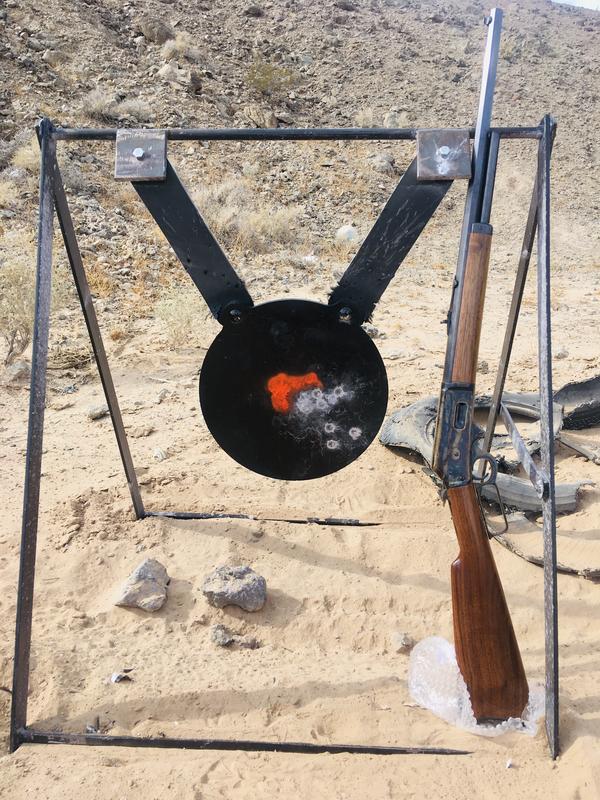

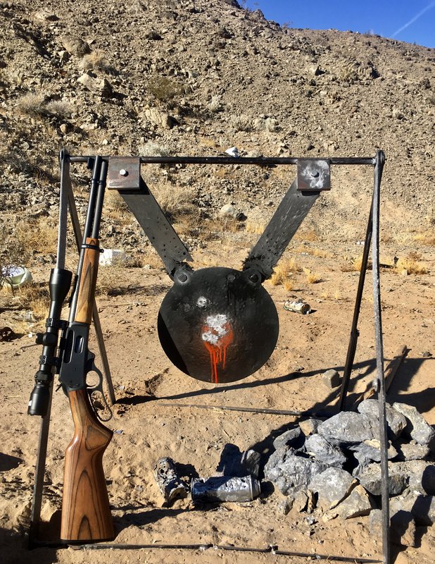

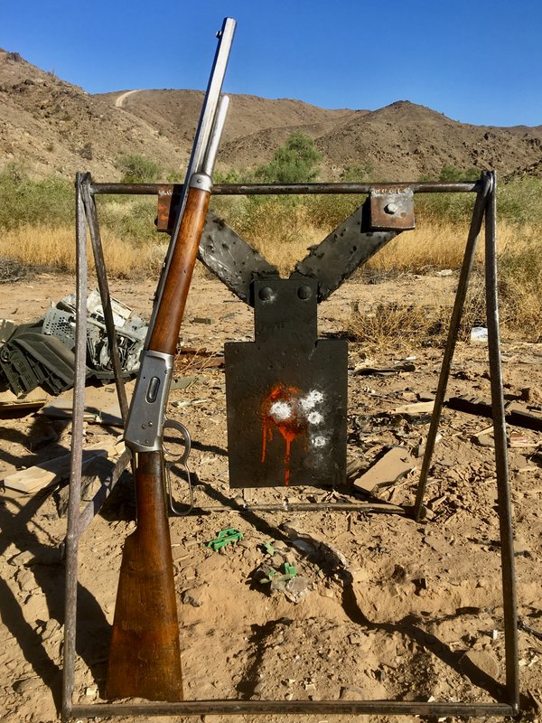

I’ve moved out of trying to do plinking rounds and such. Instead I’m just VERY intentional when I practice. If I shoot 3 rounds X gun, as I’d shoot from a deer stand, and all 3 hit my target I call it good and put the gun up. Most I’ve ever shot in 1 sitting was a full box of .357 in my SW pre27, very much bragging to say I went 50/50 on the 10” gong at 20 and 25 yards.
