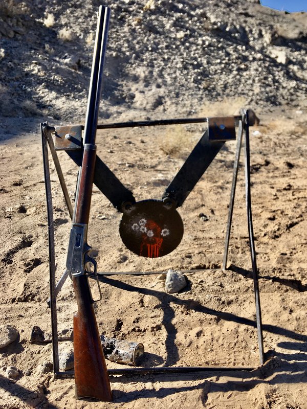

I’ve used John Taylor to reline a couple of my rifles, one of them was this Marlin 1893 in 38-55:
Before the reline it wouldn’t hit the target frame at 100 yards, groups could be measured in feet as opposed to inches.
