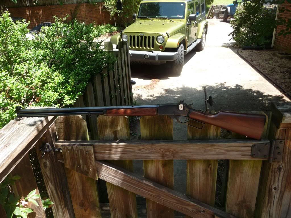

Easily done, Just grab a box of Missouri Bullet company 405gr bullets load up 30gr's(as a starting load) of IMR-4198 and go to it!! Your sights will definitely need to change however for consistency, so I put a MVA# 108 vernier on mine. I also put the Lyman L66A peep as well based on Wind's recomendation. After shooting with this combo for a while, I added the MVA Hadley Eye piece, helped a LOT and allowed me to shoot at shorter and longer ranges easier being able to change the diameter of the peep!
Here is mine, although I did trade away my Marlin 1895 in 45-70, I did put this same rig on my Marlin Cowboy in 38-55.
You using a receiver AND a tang sight!?!?
Are you looking through both apertures?
Sorry to be confused, but I don't understand how you can see through both. With my Lee Shaver tang sight I can't get in position to see through a receiver sight.
I do agree on the Hadley Eye piece.
Michael
PS: Nice Jeep
I went to two IHMSA sihlouette matches in Oklahoma a few years ago, it seems to me that the range was northeast of OKC., the directions were fuzzy even then, with "turn where the round barn used to be". and such. they did high power rifle matches there too out to 600 yards or so,. dont to the same mistake I did when I started sihlouettes, dont go to max loads, the critters will fall with loads that allow you to drive home with both hands.
Ha! No, not at the same time, I put both on there for the picture!! I use my rifles for other things besides bench shooting, so the peep is for that!! Plus, the front sight will need to be replaced with something you can file down...you'll need to...trust me!!
So, bascially, Vernier for long distance shots, or just shooting steel! The peep for everything else. The LYman peep with a push of a button slides off the receiver so it's easy on and off with same POI.
