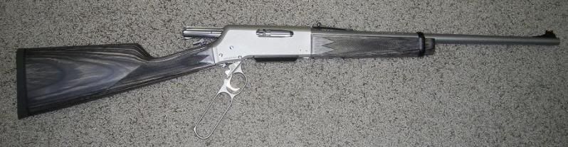

Received my new .358 Winchester BLR! Excellent fit and finish, it's flawless! The 310 gr Woodleigh RN SN bullet fits in the magazine and chambers ok, no issues with overall length. Scope mounting and load development to follow.... :biggrin::biggrin::biggrin:
WOO-HOO, good lookin' rifle there! Congratulations! Have you decided if you're gonna go the standard scope mounting route or perhaps a scout scope set-up? I'll be curious to hear whether that 310gr shoot well in your rifle. I own an older steel receiver .358 BLR and love the gun. I'd certainly enjoy owning a second one like yours too!! :biggrin:
