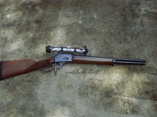

Hope these come through not too large.......
So far it likes the 180 gr. bullets best. Best group was with the 180 gr. XTP HP and it went into about a half inch at 50 yds.
Scope is on it for accuracy testing, when a load is found I will put a Tang Sight on it. It shoots sweeeet.

The round is simply a 44 Mag case necked down to 357 diameter. It was developed in the early 60's and revealed in one of the gun rags in 1964 I believe. It was designed to get high velocities out of a 357 bullet, primarily the 158 gr. I think. No forming dies are needed, just a standard 2 die set. It is suppossed to give like ballistics of the 35 Remington in the lever action. I hope it does, the 35 Rem is a grand old cartridge to imitate. The round is easy to shoot and easy to reload. Most reloading data goes from 110 gr. to 158 or 160 gr. bullets. My gun seems to like the 180 XTP HP the best. It is simply a 44 Mag. Marlin 1894S rebarreled by Brockman's Rifles in Gooding, Idaho with a new 357 barrel and rechambered to 357x44 B&D. No other adjustments needed.

I guess you could use one of the Cowboy series, they seem to be the same internaly. I used a 44 Mag 1894S and a new "Model 1894 Carbine 357 Magnum" from Gun Parts Corp.
The only other thing than rechambering is to make sure the barrel is not bending the mag tube, which you should do on any lever rifle anyway. You might have to do some minor fitting to the forend wood. You may also have to move the forend cap retaining piece, the part the forend cap screw screws into, depending on your model. The new barrel had a small hood(?) that had to be turned off which was no problem.
I don't know if you would have to time the new barrel or if it would line up on your gun.

I guess I got lucky or Brockmans did a good job of assembly as the barrel band and forend cap hasn't been a problem. After I got it back I had the idea that I should have had him also convert it to a half mag rifle. But it's nice as it is.
