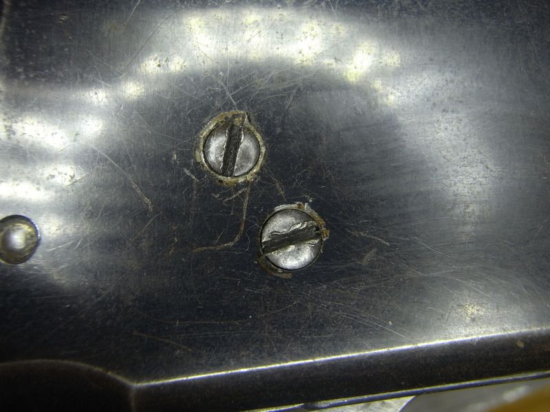

Just to show you it can be overdone heres a pic of my Winchester 94 from 1903.
See how elegantly Farmer John and his son Bubba J dismantled it with a canopener or similar dedicated object.
Thats the kind of "custom scrimshaw" i don't want on a fine rifle

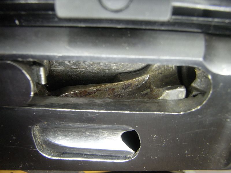

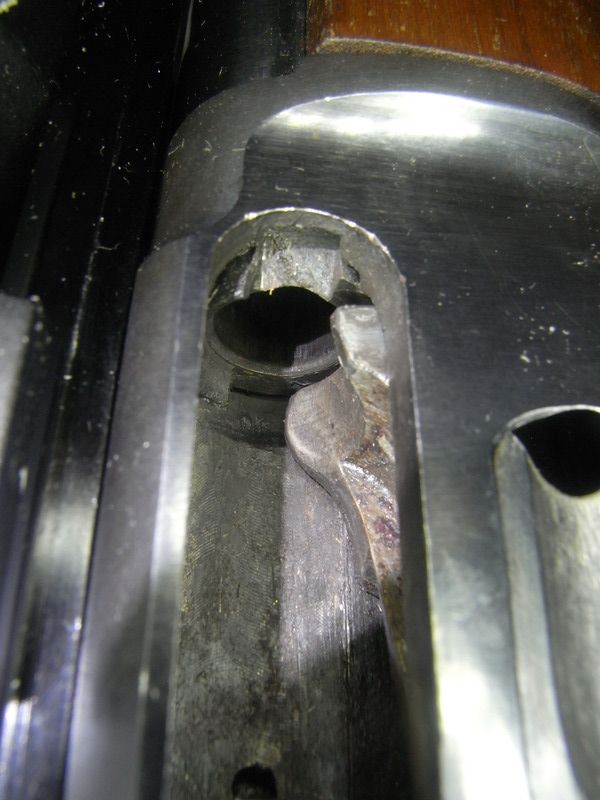

Ah the 1886, several more internal parts than the Perfect Winchester 94 or the nearly serviceable Multiscratch-Bore from that other company ( :) ) and a good bit more difficult to dis-re-assemble.
See that S shaped bar, center right? That connects the lever to the lifter it fits over/under and thru two parts simultaneously and is the reason this first reassembly took an extra hour to accomplish. I doubt it'll get disassembled often enough to learn to do it eyes closed and one hand behind my back....!
About halfway back together with this rather busy action design and finally, the S-bar linking the lifter to lever is in place, samwiched in there behind the lifter and locking lugs. Wonderfull action, durn complex....and the benefit of the complexity? Unlike Marlin and Win 94, the 1886 Win has large/deep dual vertical locking lugs and a massive bolt instead of a single angle faced locking bolt (ala Marlin) or the much smaller lugs and springier bolt of the 94.
