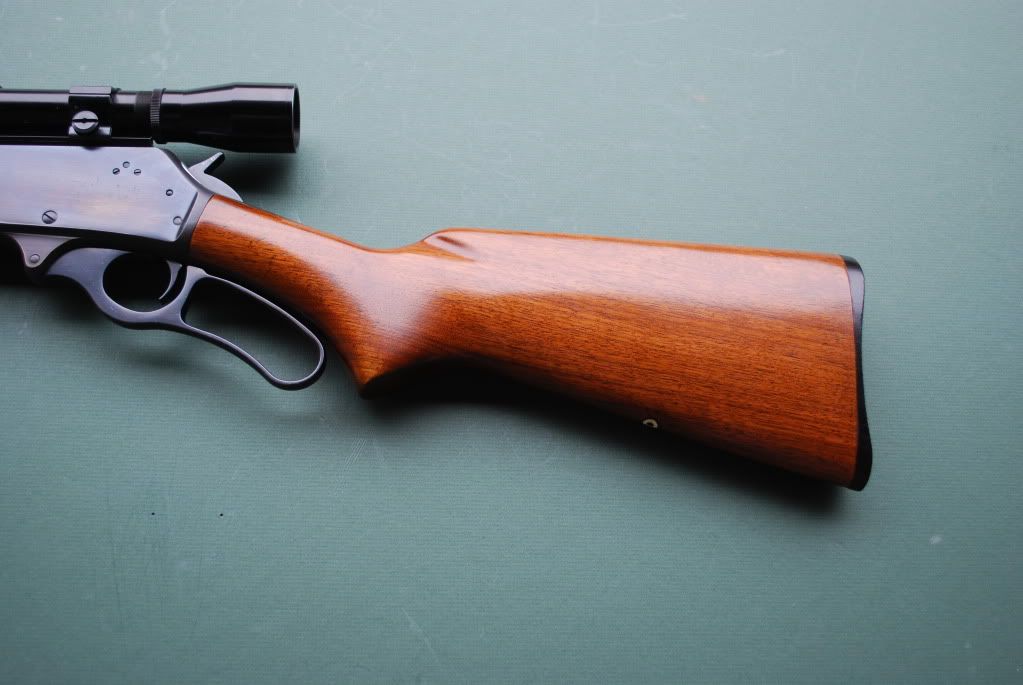

Although I'm not quite ready, I'm lining up my ducks for refinishing the stock and forearm
I've been reading any forum and viewing any youtube I could find on the subject but my question boils down to this:
  • For a 1955 model, Tru Oil or BLO?
The 32 special is a 1952 version that was in horrible shape from a pawn shop. bubba carved his name in the stock and forearm and I had to refinish because I could not walk around with a rifle with someone elses name on it. the 1895 is a remlin I bought about 1-1/2 yrs ago and was sent back to remlin to fix an apparent crack in the receiver (see sticky in 45-70 section I started the alert) I could not get any accuracy with the rifle and scout set-up so when I took it all the way down I decided the faux checkering had to go and I liked the perch belly on the 32 so I mimicked that when I did it. surely the wood is nicer than with the faux checkering.
My Pop's was a true woodworker/woodsmith and if he was with us today he would have told me I should have used the BLO I am sure, but the tru-oil was easy to work with and with many coats and steel wool in between it turned out better than I would have expected.
the 336 is a satin finish 9steel wool last step) and the 1895 I left glossy due to the pretty eagle cuff from MO member.
