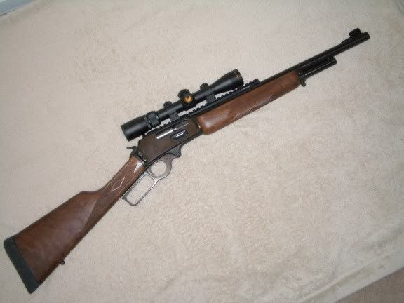

I have a Nikon Prostaff 2-7x32mm on my SBL w/ Leupold PRW's.
I'm not sure if they are medium or highs(bought them new from a guy, but he didnt have box for them)
Here It Is!!(and yes the bi-pod is for pic purposes only lol)
This is actually the pic I saw that made me go with a rail instead of A back up xs sight and qr ring setup Thank you sir ;)

Here's my 1895G w/LeverRail and Nikon ProStaff 2-7x32mm, using Warne QD "Medium" rings.
These rings are .375" (3/8") high. The "Low" rings are .25" (1/4") high. Height is measured on the Warne rings from where the ring mounts to the rail, to the bottom of the ring, where the scope sits.
The way this scope is mounted, there's no way that I could get the rear sight (ghost ring) mounted and useable.
(Suits me just fine. These old eyes can't focus on the front sight too well, anyhow!) :'(
If I'm not mistaken, the "High" Warne QD rings are .50" (1/2").
Judging by your pic I would have to say that my PRW's are Mediums as well, scopes are sitting virtually indentical!
If I had of used High's I prolly could of had enough clearance over the Ghost Ring, allowing me to mount scope more rearward.
Would of been close for sure.
