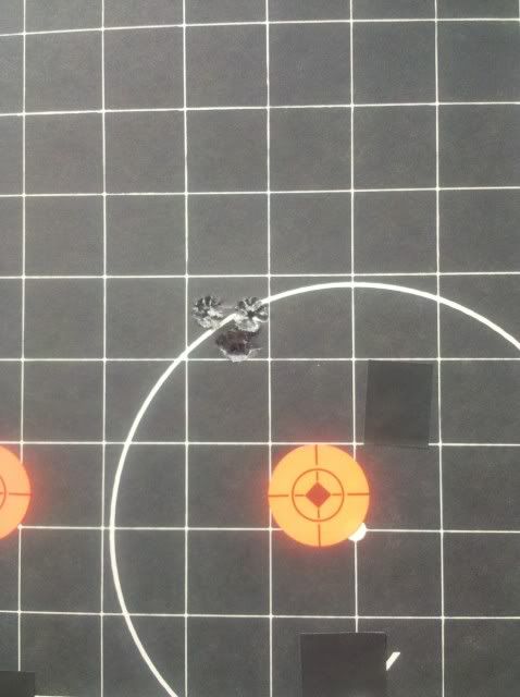

It was warm enough to go shooting today temp 55 degrees, Wind 10-15 MPH and more wind than I like but hea it beats not shooting. Relative humidity 81% Pressure 26.96. I only got 3 loads shot for the 308MX. I figured I would try the Hornady 150 gr GMX #30370. this bullet would only be able to be loaded with one in the chamber and one in the mag, but I figured it would be fun to work up anyway. I shot Leverevolution powder, the targets were shot at 100 yards with the wind at my back with a right to left quartering angle across the range. 42.0 gr = 1.5 inch, 42.5 gr = .25 inch..yes 1/4 inch, and 43.0 gr 1.75 inch. Hornady brasss and Win LR primer
Pic of the 42.5 gr 150 gr GMX load
