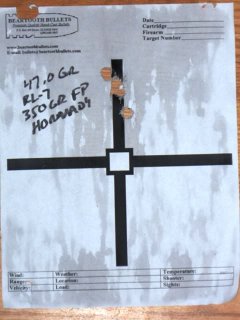

Here is a pic of the gun as it sits now with my Leupold Scout in Gun Metal Gray atop it.
We went to the range today, (we being me, the 1895 and a Romeo y Julietta Bully) after loading an assortment of 350gr Hornady FP's on five different charges of RL-7. All loads were in new Starline brass, with WLR primers and seated to the crimp groove. 5 Shot groups were fired from Lead Sled at 50yds.
The weather was cool and wet( go figure, I live in Western Washington) and the range was mine, mine, mine, all mine, not another soul there. ;D ;D ;D ;D ;D
The loads were 45, 46,47,48 and 49 grains respectively, and the data is as follows;
45.0grs, Velocities- 1616,1666,1688,1663,1679- Avg. 1668 FPS
46.0grs Velocities- 1704,1712,1699,1737,1689- Avg. 1708 FPS
47.0grs
Velocities- 1786,1820,1810,1781,1821- Avg. 1803 FPS
48.0grs
Velocities- 1844,1825,1836,1817,1815- Avg 1827 FPS
49.0grs Velocities- 1840,1869,1824,1846,1845- Avg 1844
So, although all the groups are good, it seems my gun likes it better the faster I push them. Having said that, I think I will stick with the 48gr load as it is almost as nice of a group as the 49gr, but that extra grain of powder did not pay much dividend in velocity. It did make the lever start to pop open upon firing though, so 48grs it is. Hope this is helpful to someone, I couldn't have done it without the help of so many folk here.
As much as I love the Piledriver Jr's, I think for deer, elk and bear in my home state, this Hornady 350gr FP may be a really good choice. I think the PD's will be better when I take a Bison though, or bigger bears and hopefully African game someday. All opinions welcome.
Oh, and BTW, this was a 1 Knob Creek post, thought it might take two, but I'll have to enjoy the second one over the replies.

Although I have not tried Reloder7 with 350gr bullets, just cast and jacketed in 405gr, I found that accuracy always went up considerably as charge weights went up. Not all powders have behaved like that in .45-70 for me, but I never got good accuracy with reloder7 until the charge was within say 2 grains from max.
Chris.
Chris.
This is the first time I have used Reloader 7 for anything, but my results certainly bear that out. There are many on here that swear by it, and I can see why with results like these.
539 Posts
It is also interesting to note that as the velocity of the rounds increased, the shot group patterned lower on the target.
152 Posts
As to the group patterning lower on the target for faster loads go, I suspect that its a case of the bullet exiting the barrel faster under recoil/barrel jump that causes it to hit the target for a lower POI.
190 Posts
Discussion Starter · #15 ·
Sorry, should have put that in the post, I adjusted the scope down a little between 47 and 48 grains. That is why the groups are lower.
