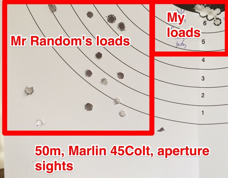

Several years ago I received some homeloads when I bought a secondhand Marlin 1894 Cowboy LTD. These were .45Colt gallery loads that "shot really well", according to the seller of the gun. He didn't want any money for them and so they were duly signed over. Since they were being shot through the same gun I thought they would be good for plinking/practice etc.
Back home the ammunition was locked away and I shot the gun for years using my own homeloads.
Today I decided to free up some space in the cabinet and so I took the donated rounds to the range, along with some of my usual homeloads.
The donated loads were terrible. So much so I thought the sight was loose, or the gun damaged in some way. To my relief, when I used my own loads she shot as beautifully as ever, albeit in a brisk crosswind:

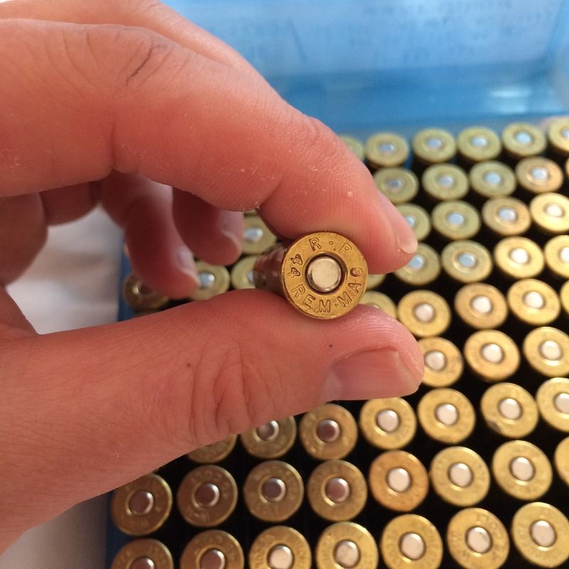

I inspected the remaining donated loads: primer-seating was uneven, variable OAL, some shaved bullets, one backwards primer...
...and this hidden gem in a second box. Can you spot it?
It's a 44mag case that's been through a 45Colt die set and has been stuffed with a .454 bullet instead of a .429 :
It doesn't show well in the pic but the whole round
(the one on the left) is kinked!
Moral of the story- there's no such thing as a free lunch!

Mr. Random probably did what I did.
I bought two boxes of Remington .45 Colt brass at the local gun shop. I carried them home and opened the boxes to place the new brass in my plastic MTM boxes, to begin working them up for loading. When I began sizing them, I found one shell in the first box that was entering the sizing die with no resistance, so, I looked and found a R-P marked .44 mag case. OK, now I'm short one .45 Colt case. When I began working the second box of brass, bingo, I found another .44 mag case. Out of 200 cases, 198 were .45 Colt, and 2 were .44 mag. All new virgin brass that I get, I size, trim, chamfer and de-burr before anything else is done for reloading. I strive to make good quality reloads, and attention to details really pays off.
Mr. Random probably didn't size his new brass before loading them, and didn't catch the mistake. He just primed the new cases, loaded some powder, and shoved a bullet in the case, and apparently not inspecting his product. Mr. Random is a very careless reloader. I personally do not shoot anyone else's reloads.
