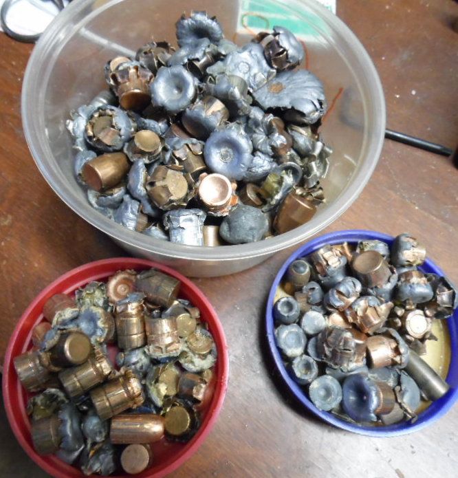

I've been testing factory ammo and digging bullets out of assorted media for about 30 years, and since I'm a cheap so-and-so, I often kept the recovered slugs for comparison. As a result, I currently have forty or fifty pounds of fired slugs in buckets, jars, boxes, drawers, they're all over the place. Since most of them came from hollowpoint ammo, I suspect the cores are made from some fairly soft alloys, and would be perfect for re-casting into new boolits for my rifles, with a little tin added. Some of them shed their jackets on impact, and of course those would simply be tossed into the lead pot without any further ado.
The other side of the issue is all those other bullets..........the cup-and-core designs, the Silvertips with aluminum-alloy jackets, the bonded-core bullets, that stuff. I'm inclined to just melt a bunch of my regular alloy, toss a handful of the recovered slugs, and hope the lead melts out, leaving the jackets to float to the top and be skimmed off.
Anyone do this? I don't want to contaminate my alloy with something not conducive to my +-12 BHN mix, is there anything to watch out for? Skip the Silvertips? Avoid the Gold Dots? I could recover a pretty fair amount of lead if this works.

sure thing, man...I've been mining the backstop for years. I do put 'em all in a cold pot/kettle and let 'em come up to temp, with a cover on it...cause the outdoorsy types get water in under the jacket. Yours probably don't have that problem. Everything averages out to about 1-25 or 1-30 tin/lead and makes fine mild load stuff.

They will work just fine. You can either place them in a pot with other alloy or melt them straight from an empty pot. The lead melts out of the jackets and you skim them off the surface same as melting any other scrap. Some folks have reported success in selling the empty jackets to their scrap yar as #2 copper,but none of the yards around here will touch them. But with the price for copper these days, it is worth asking.
My experience with range scrap is that jacketed cores are not pure lead or even close to it. The indoor range scrap that I've been using for many years is very close to WW (12-14 BHN).

I suspect that in at least some cases, the last poster is right on as to "J" bullet alloy.
For example, maybe an extreme one, but having sectioned such things as Speer Grand Slams, the rear most portion of the core is clearly different then the forward or expanding portion. Much harder!
Then Mr surveyor's comment seems very good considering you do have some lbs. of the range lead.
