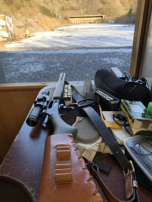

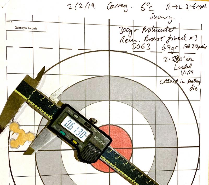

I took some new homeloads to the 100m range today: Sierra Prohunter 300gr over various charge weights of DO63 (AA1680 in the USA). I have been using cast until now but wanted to see what the Remlin GSBL can do with jacketed.
I had other guns to shoot and by the time I got round to shooting my Marlin GSBL, the range was soon to close so I only had time to fire the lowest charge.
It shot really well at 110yds so I just zero'd it (I'd made up extra of the lowest charge in case I wasn't on paper) and called it a day!

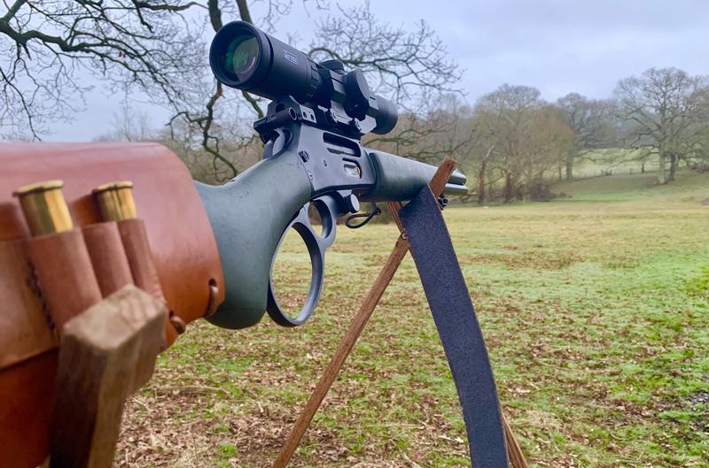

The load is now field-tested- it performed very nicely. Deer dropped after short dead-run (no tracking needed). Meat damage acceptable.
The gun is a delight for this sort of close range hunting (this young buck was taken at 60yds)
GSBL on sticks:
