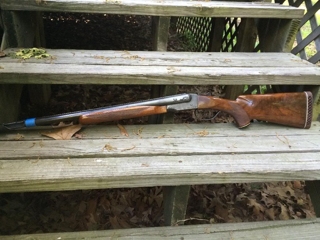

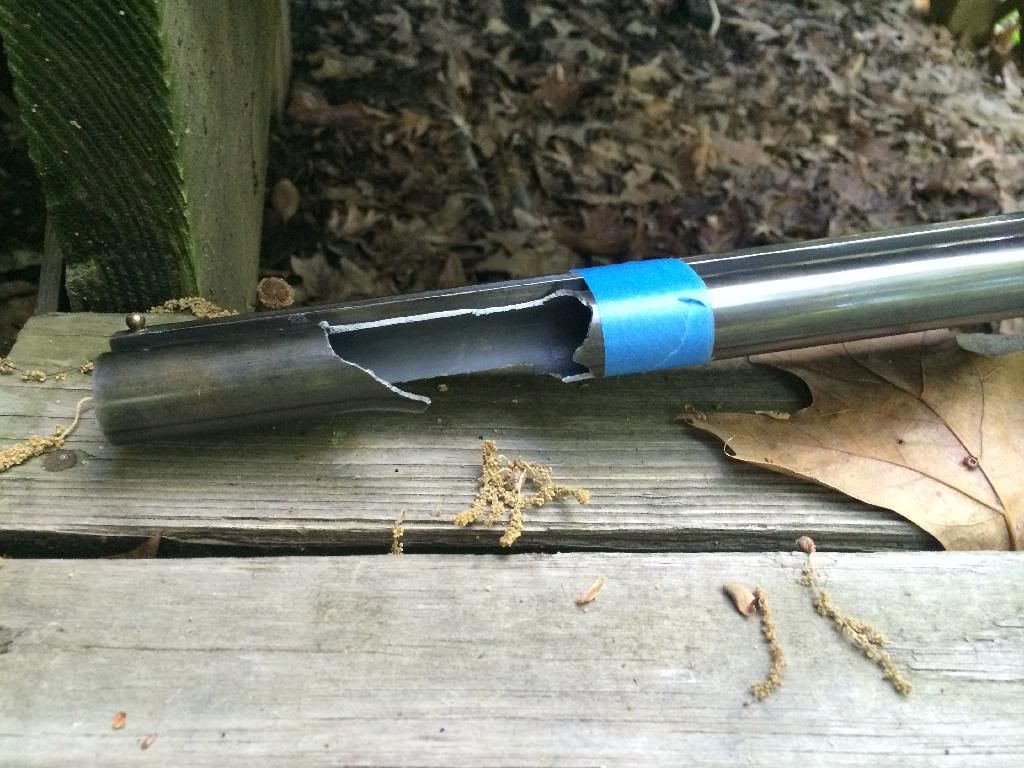

After seeing the stock set on this 311C a few years ago I on and off pestered a friend of mine about buying it. He called me a few months ago and asked if I were still interested...but there was a catch. They were at the range and didn't notice a squib load in on side of the barrel.... it should clean up really nicely around 20" luckily for me. Originally it was going to get sent to the gunsmith but the more I looked at it the more I just wanted to do it myself and have a little fun.
So the first is the obvious. Going to get the chop tonight and hope that it won't require to much solder work when I'm finished, then clean it up. Going to attempt to make a brass bead from it on the lathe, thread it, and drill/tap a hole on the rib. Have a few inches of old barrel rib to try it on first!

Actually, the side bulge/burst was far enough forward in the barrel that the shrapnel went away from my friend and his father shooting. If he had not been on the end of the lanes it would have peppered anyone next to them or down the line though! They accounted it to a lodged wad - but we might never know.

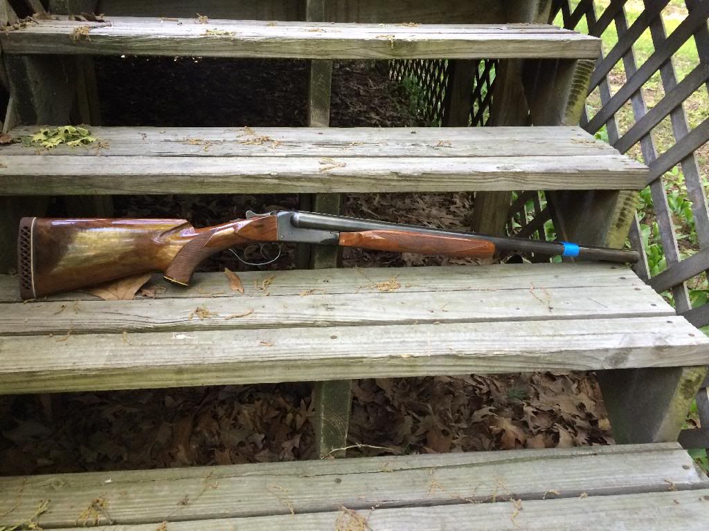

And back together for now:

Got the muzzle cleaned up on a stone last night which looks really nice now. Guess the next step is to pack the end with some steel wool and fill it up with solder.
