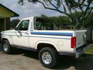

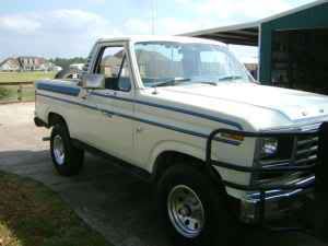

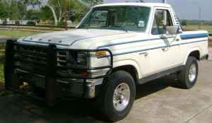

picked up an old Bronco
2610 Views 21 Replies 13 Participants Last post by  ochretoe
6
so far had to change the lock cylinder, the old one was a "no key required",
got the left rear axle out, seal is leaking, getting new bearing/retainer pressed on
TTB up front looks pretty crusty, thats gonna be a nightmare, I anticipate a torch, BFH and PB blaster in my future
looks like the forks in the transfer case are shot, haven't looked in there yet but the selector is in 2WD and underneath it is safetywired, probably kept popping out.
the ol 300 runs good but leaks a lot of oil, just pushrod cover and valve cover gaskets will help
she's got either a 435 or BW T18 granny 4 speed. 1st is NOT synchro ;D
all u-joints look like they were put on when Uncle Ronnie was still gov of California :eek:
but she's all there, no cancer, nice and straight
