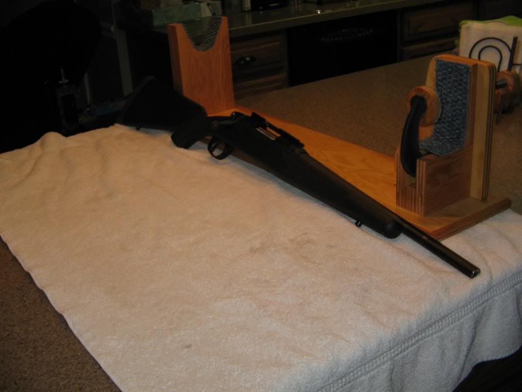

Yep fellers 223 ''''' It has Been cold Up Here in Utah so I had a little extra time on My Hands . So I installed a 223 barrel on this feller . When It Gets warmer I will give her a go and Post The Targets DD

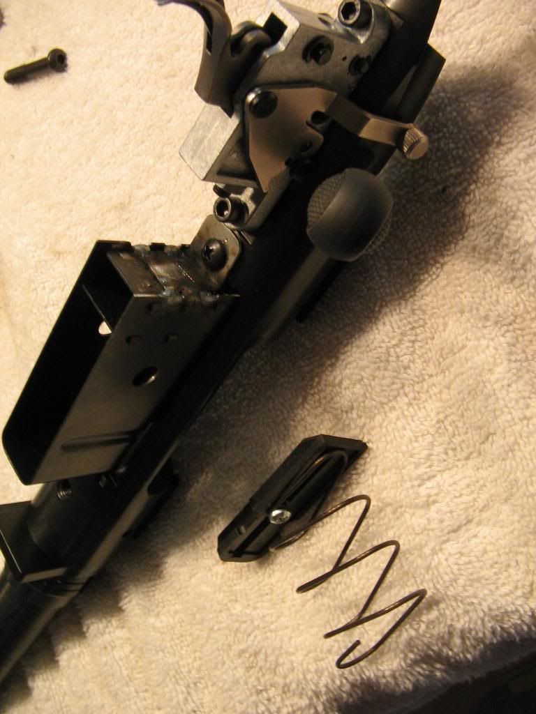

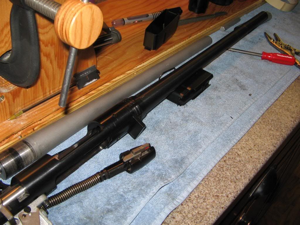

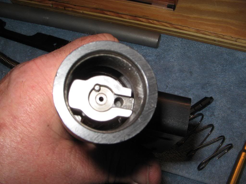

It Took some Thinking and a lot of compairing parts . It is Not a throw togather deal I started with a Savage 223 small pin bolt head . Had to tig the marlin holes up in the bolt body build a spacer and a few jigs . The magizine is also a savage stagger feed witch I had to wield a tab to retain it .One of the biggest deals was getting the fireing Pin Produsion set But Now I have some blue prints .
The gun Is Bedded and scoped Ready to Shoot ... If The weather warms up above 30 I will go to the range.
I have test Fired It Looks great DD Thanks For the Kind words fellers

Hi Dan, thanks for the Bolt Head manufacturing description. I had looked at the Marlin head in comparison to the Savage
and come to the conclusion it could be tricky to convert.

Hi Dan, that does raise a good question, when you made the .223 Bolt head, how did
you make the slot for the extractor? small file after milling the basic slot?
869 Posts
Discussion Starter #20
No File Just a Mill , I used The Marlin Extractor in the Savage bolt head DD
