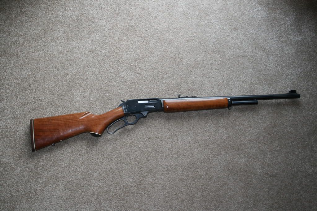

Here's some pictures of the new addition to my family.
The gun as I found it:
I really like the balance of this gun without a scope. I decided on the Williams FP-94/36 sight, since it seemed to have a lower profile that some of the others. I've never installed this - or worked on removing the older dovetail rear sight, but it wasn't too hard.
I did notice that the sight wasn't completely flush on top of the receiver. There was about 1/16" between the receiver and the horizontal bar. I've been doing some careful filing on the contact point and I almost have it flush. I've been taking off just a little at a time and checking the fit. Once I get it down where I want, I plan on going over it with a stone to smooth things out.
A couple of questions:
1. What stones do you recommend for me to purchase? I'm just getting into some of this and want to do it right.
2. Is there a finish I should do on the exposed Aluminum? I'm more worried about damage to the gun than to the sight.
I'll post a couple of close-ups of the sight when I'm finished.
Thanks

Don't worry abouts the gap between the sight and the receiver...that amount depends on WHERE the groups are hitting...you might need to stone it down, but more likely you will need to run the sight up a bit to get the right POI...I like 1.5" above the center which gives you a point blank out to about 200-225 yds...no need to figure drop or hold over just put the bead on the shoulder and go collect your steak. ;D
Brownells has a nice selection of stones of every sort...a fine/extra fine diamond or hard Arkansas will work and Aluminum black will work or just plain nail polish, epoxy glue, paint or there are many ways to hard coat or anodize aluminum...or leave it alone...

Got the same sight on my 444XLR. It doesn't go down to touch the receiver. It just needs a taller front sight.
Hal - what front sights have you used / would recommend?
3,089 Posts
Mine came with two fiber optic front sights. I usually buy something around .350 to .400 to go with my receiver sights. Most places sell the rear sights by themselves, but recently I've found a set with two fiber fronts at Natchez for my new 336SS.
As far as solid post types, I've used .400 Millett Sights with wide white ramps for my big bores. If you want thinner for aiming at smaller critters than XS sights have white ramps at about 1/3 as thick.

I have several Williams FP's including one 94/36 and I'm not sure what you're trying to do with the filing. All of mine sit up off the receiver to some degree or another. As Hal said, if you're shooting high, then you would need a taller front sight.

Eli: As NFG pointed out, I was being a bit too anal with the sight. After I put the sight on the first time, in my mind (analytically crazed to be sure) it should have been flush with the receiver. My wife was laughing at me last night when I told her that filing the sight down wasn't necessary (she thought I was crazy too).
