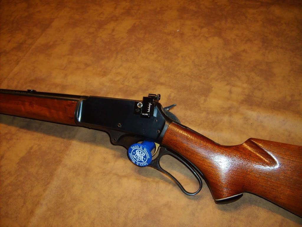

ok so im in the process of building a 219 out of an old marlin 336 (pre scope mounts) and i don't want to drill and tap my reciever for a top mounted sight but i want to run peep sights for a better sight accuracy than the standard ones. That leaves me with two options. A lyman side mount (there are a couple of little drilled and tapped holes in my receiver that im assuming are for this) or a skinner barrel mount. Now the barrel i am using already has the dovetails cut for the barrel sights which make the skinner barrel sight tempting but with iron i know distance between sights is my friend. So whats everyone's opinions.

yea im leaning towards the reciever sight as it will probably be more accurate but since my barrel has dovetails already cut i was thinking it would look cleaner it i used the skinner.Any one use the skinner barrel mount that want to throw in an opinion on how it works.

wow thanks for that review. I know that the reciever sight would be more accurate, but the skinner sight looks very clean.
That Skinner does look good. But, I think my recommendation would be for the receiver mounted aperture. The increased sight radius alone is enough reason to do it.
