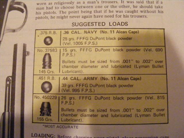

That particular bullet is designed for a .36 cal cap and ball revolver. I would not have great expectations for it in a rifle that normally needs a bullet of at least .379 diameter.
Try it and see how it shoots.
Hey there FredT -- Quick sit down and put your head between your knees and snarfle down a couple of Twinkies -- Hurry!! I think either your blood sugar is low or you're having a Senior Momment!! Here is where I was getting my information. Hope this helps and wishing Fred a speedy recovery. Man-o-man, that was a close call. Best regards. Wind
Well I am over 50 and I am a type II diabetic...
I never saw that loading page.
This is the one I have.
Sorry to have raised the blood preasure.
After doing more research I do see that the said projectile is in my Lyman #39 and #41 manuals for the .38-55.
Ya know I do like Twinkies.
Hey there FredT -- That's what makes this such a fun journey!! The wealth of information at our disposal thanks to computers. Those bullets remind me a lot of some "Pickett Bullets" I had for my 1861 Remington Navy (transition) revolver. And all I can say is a picture of a picture must be worth 2,000 words??!! Best regards. Wind
