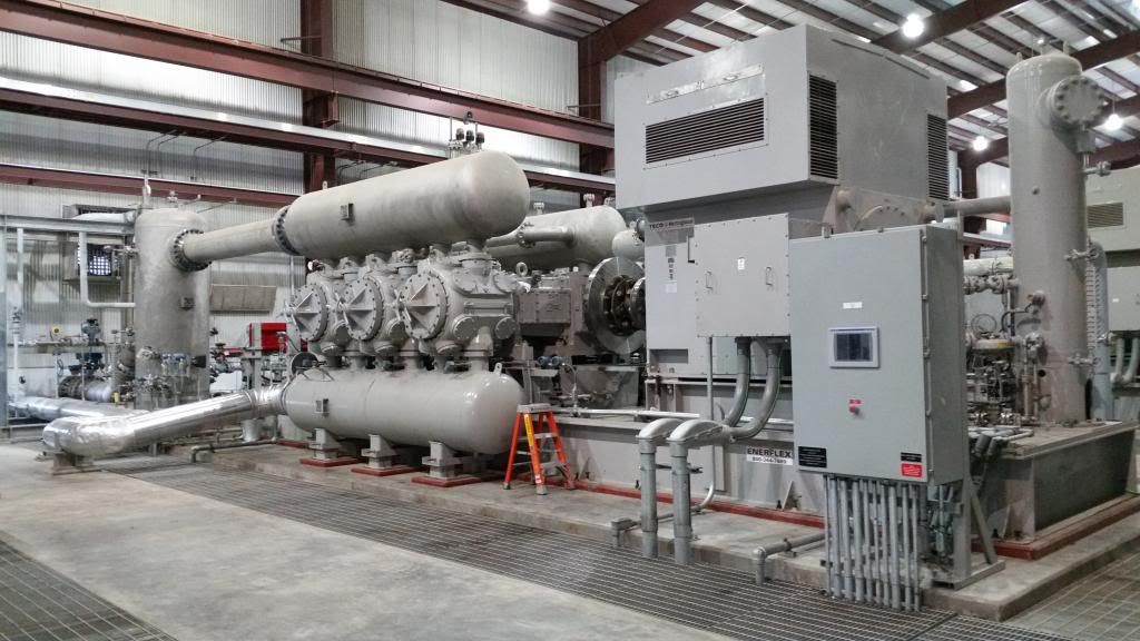

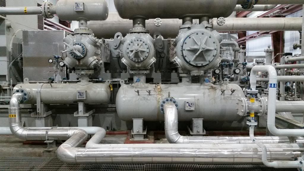

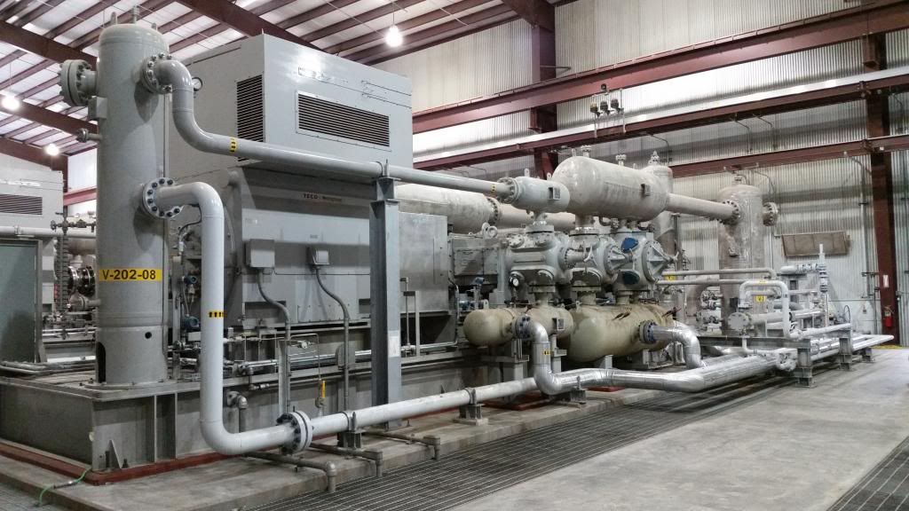

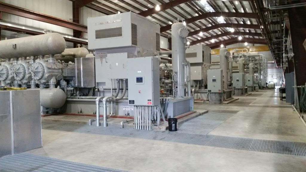

I work in gas and natural gas handling and processing facilities all over the west and really enjoy it for the equipment and technology involved. This facility is a CO2 compression station outside of Coffeyville Kansas. Unlike the others I've worked in, this one has all stainless steel piping and vessels due to the corrosive nature of H2S gas.
4 Compressors and 2 blowers
Compressors are 6 cylinder 4 stage and 4,000 Hp, 4,160 Volts AC electric motor driven
Compressor discharge is 1,250 psi
The blowers take the CO2 from a very low pressure, 2 to 5 psi, to 10 psi to give the compressors suction capability

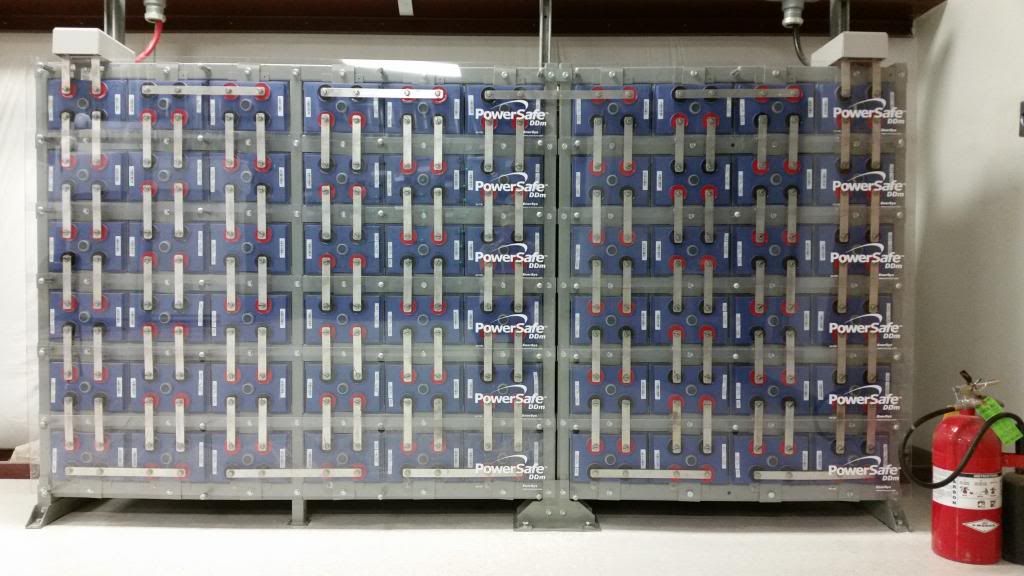

DC battery back up for emergency power. 60 batteries connected in series

I forgot to mention in my original post. The CO2 is sent via pipeline down into Oklahoma to the old oilfields that their production rates have dropped to around 25 barrels per day. These fields are water flooded down in the formations, then the CO2 is injected at high pressure (2,500 to 3,000 psi). This forces the oil and water into the pump zones and boosts recovery rates as high as 125 barrels per day. The oil, water and CO2 are then separated. The oil is pumped to distribution terminals and the water and CO2 are recycled.

You're so right, Horseshoe. There are various gas detectors located in the building and around the machines. It's the second most deadliest gas known to man. We have small portable detectors that clip on our collars or hard hats that will sound off and vibrate when a minimal amount of the gas is detected.

Where I worked before I retired we had 96,000 sq ft of raised floor entirely populated with servers, tape silos, storage disc and mainframes. We processed for DoD and all four branches of the military. Downtime was verboten.
The back of the building was dedicated to facilities where we had an entire room dedicated to banks of batteries and everything that supported the UPS (uninterrupted Power Supply).
Through the next door were the chillers that had piping and turbines and looked a bit like your first picture.
Diesel engines outside took over after the system detected and reacted to commercial power outage.
But on another note, You see the intercell connectors on that bank of batteries in your last picture that connect each to the other. Those lead connectors make good bullets.

I'm proud to say the company I work for had the full engineering package on this facility. I was there with another engineer to verify the controls and instruments were wired according to the drawings.
