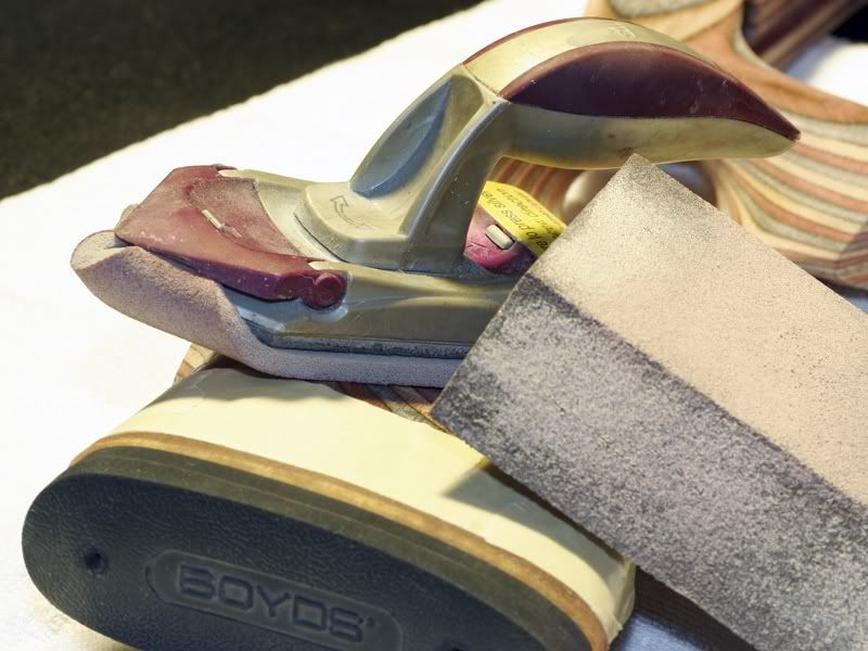

Why use a sanding "block" instead of just a strip of plain old sandpaper ? The sanding block (or in my case, the 3M "SandBlaster" tool), gives you a firm, straight edge to work with, lessening the chances of getting ridges or lumps on the finished product. These simple tools allow a better grip and, thus, better control over your work. They are inexpensive and can be used many, many times without wearing out.

So far so good, right ? We've got the excess material removed and we've moved on to the final steps. Next, remove the masking tape from the stock portion to expose the wood. Now, mask off the rubber recoil pad one more time using at least two layers of tape. This allows you to carefully sand the polymer material flush to the rifle stock. Get your medium grit sanding block or pad and finish removing the excess material a little at a time. Gentle sanding from wood toward rubber gives you a smooth transition from wood to polymer to rubber, without bumps or ridges. Once you are satisfied with that, move on to the finer grit and keep sanding until it's about as smooth as you can make it. Generally, I like to sand toward the rubber (again). Use a bright work light to check your progress - better to take off too little than too much at this point. The objective is to make this appear as "seamless" as possible. As your work progresses, you'll be able to both see and feel how the polymer material is being fitted to the stock.
Keep sanding until you cannot feel any bumps or ridges. Sanding across the "grain" of the polymer is good for removing material, sanding with the grain (long strokes along the length of the spacer) works to smooth the surface for final finishing. By using progressively finer grits, you can make these polymer spacers go from a dull matte to a finely polished sheen.
Last step - mask off the wood of the butt-stock with fresh tape, being careful to make it butt right up to the polymer spacer, leaving the recoil pad exposed. Using your fine grit sanding block, put the final touches on your gorgeous new spacer by sanding gently to blend the area where the spacer meets the rubber. I use long, flowing strokes, going in a circle around the entire area, being careful to check my progress as I go. By masking the wood and not the rubber recoil pad, you won't risk any sanding marks on your stocks as you sand across the grain of the wood because it is protected by the masking tape. Got it so far ? Great !
