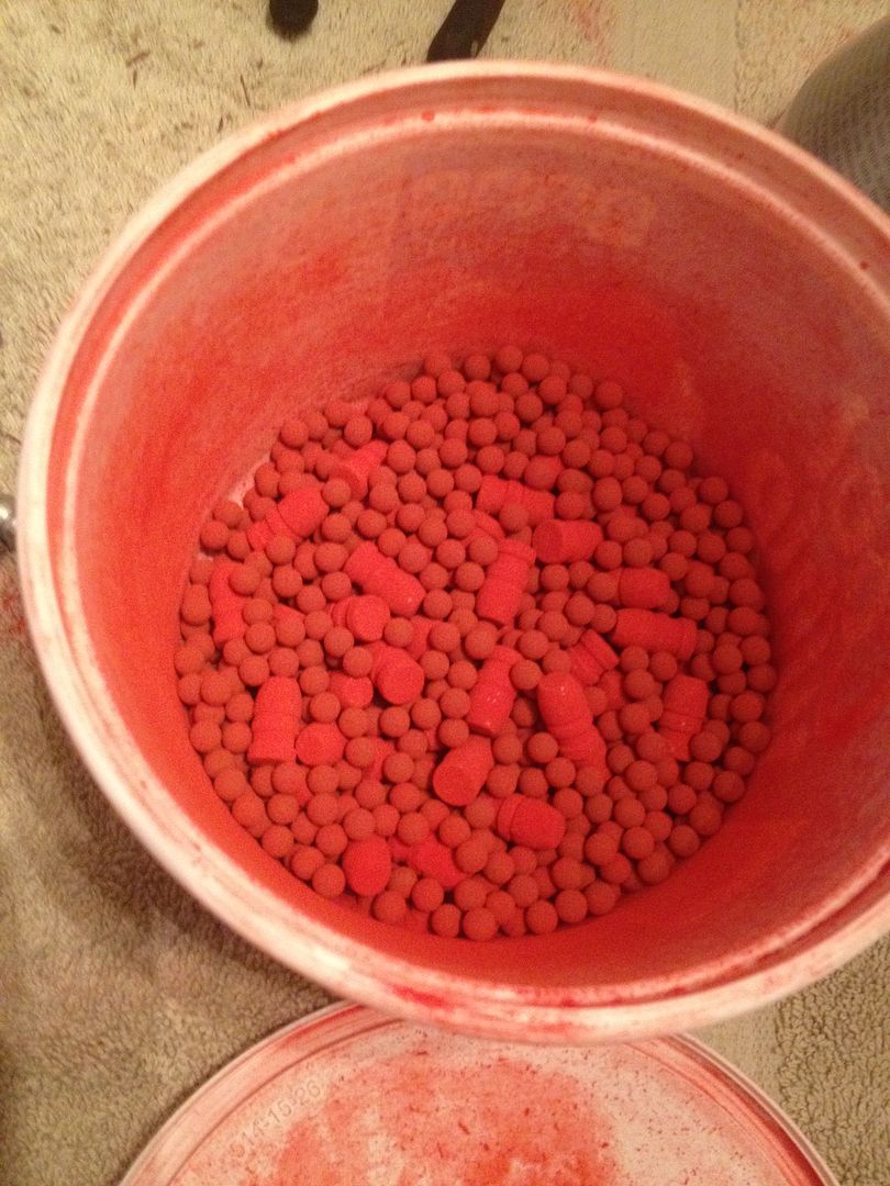

Different grade plastics conduct static electricity differently. The #5 plastic is considered the best conductor. Cool Whip tubs are made from #5, so that is what I use. The black airsoft BBs from Walmart are also considered the best, so I layer the bottom of the tub with a small amount. Then I add about two dozen bullets depending on the size.
I then add a teaspoon of Harbor Freight red powder coat paint to the tub. The Harbor Freight red is the only color they make that works well with the shake and bake method. Other sources online sell a wide variety of colors that work very well, but they do cost a little more. This stuff lasts so well I would have no problem spending the extra money for a variety of colors.
I swirl it around for about a minute (thirty seconds is probably the reality of it), and then I shake it up and down vigorously several times. If done properly the bullets will have a nice even coating.

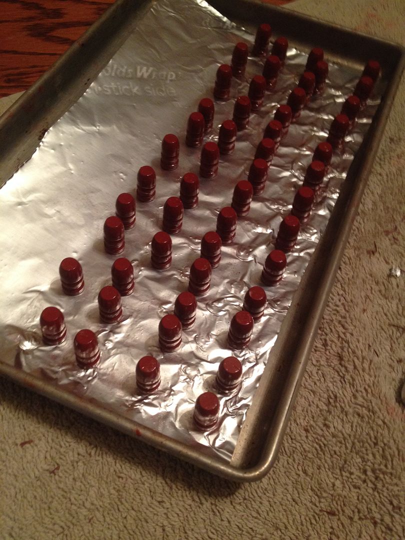

I've tried various methods for placing the bullets on the baking pan, but a nitrile glove with a bit of powder rubbed on the index and thumb works the fastest. The light coating on the gloves prevents the powder from coming off the bullets. I grab them by the nose and start lining them up on a baking pan lined with non-stick foil. You can get a good number of bullets on the pan, just don't let them touch.
Then I put them in a toaster oven at 400 degrees for fifteen minutes. I found a used toaster oven at Goodwill for six bucks. Works like a charm.
Fifteen minutes later and they are ready to use.
