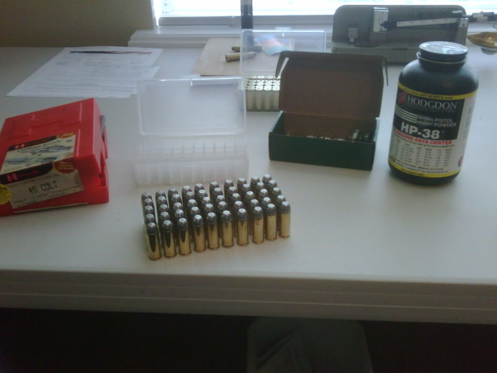

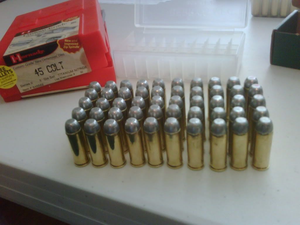

Last night I loaded ten rounds of 45 Colt, ran to the range this morning and shot em to see how they performed. No range pictures, wasn't there long enough!
Came home and loaded up fifty rounds. I'll play some more with them next week. Used some hard cast 250gr over 7.1 grains of HP-38. These rounds are for my Judge (no 45 Colt lever yet). Loaded my first box of 44 Mag this week also. The 44 mag are for my lever...... Been reloading for the 444 & 45/70 so these shorter rounds are really different. No lube is nice!

They look great--how'd they shoot ? When you get those .45 Colts figured out I'll do you a really big favor. Send me a couple hundred and I'll test them in my 1894CB and my 4 S&W's and I'll give ya the straight poop on what ya' need to adjust--won't charge ya' a thing--just trying to help out. ::) ;D ::) ;D

Looks good Scott. I never used HP-38 for anything so let us know what your end results are. Sounds like you need another Marlin in your corral (maybe unported :eek:.)

I’m really fond of HP-38 in 45 Colt loads.
I’ve settled on 7.5 grains with Starline brass, WLP pimers, and 250g Oregon Trail RNFP bullets.
Every batch has had single digit SDs, and in my Blackhawk shoots to the same POA as my Power Pistol/XTP load.
My first group with these in my 1894 was a cloverleaf at 25 yards.
The only thing that might ever change is that I’ve got a batch of the Dardas bullets to evaluate.
--scott

I have used 7 & 7.5g W231/HP38 to great success.
Try some Unique with those bullets and you might like it too.
8 ~ 9 grains under that bullet will give you 8 ~ 900fps.

I've been putting a 250gr LRNFP over 11.6gr of Blue Dot. Don't have a chrono, but I've been keeping them in a 4" group @ 40 yds out of my S&W 25-5. They feel a little more snappy than most factory (weak) loads for the .45 Colt without getting ridiculous.

Doug, they shot true and I had no problem at 25 yards with keeping em on the target. No chrony so don't know speed but liked em. HP-38 smokes a bit but not too bad.
I did spy a Marlin Limited 45 Colt that would be a great candidate to buy and port but it was out of my price range this year. I'm already working a deal with one of our well known members that loves 336SC's. Don't have a thuty-thuty Guide Gun and now I see a possibility thanks to him.
Steve, shot straight and with authority! I've loaded a bunch of 265gr 444 this week that I can't wait to get out and try in the 444P this weekend!
