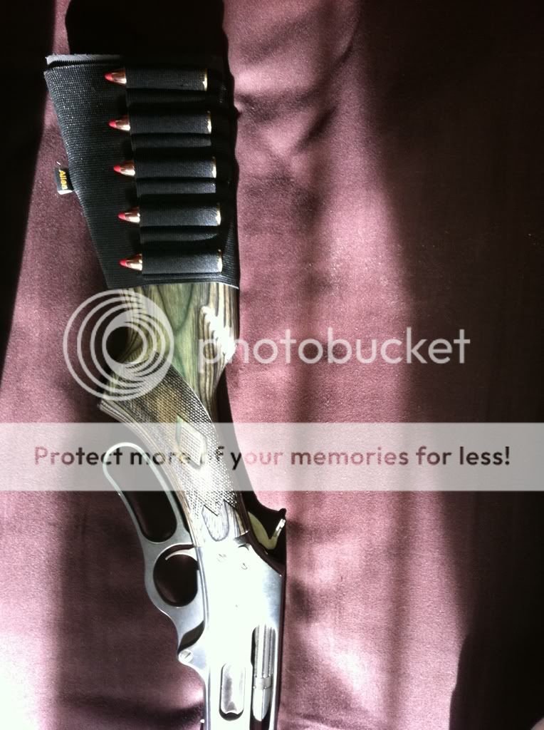

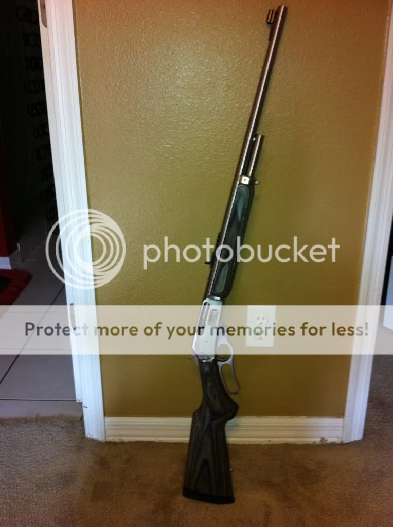

Hey guys can you give me some advice on a good cleaning kit for my new 1895? I can't seem to find much information on the best way to clean the gun or what to use. Thanks so much! Here are some pics of it!
