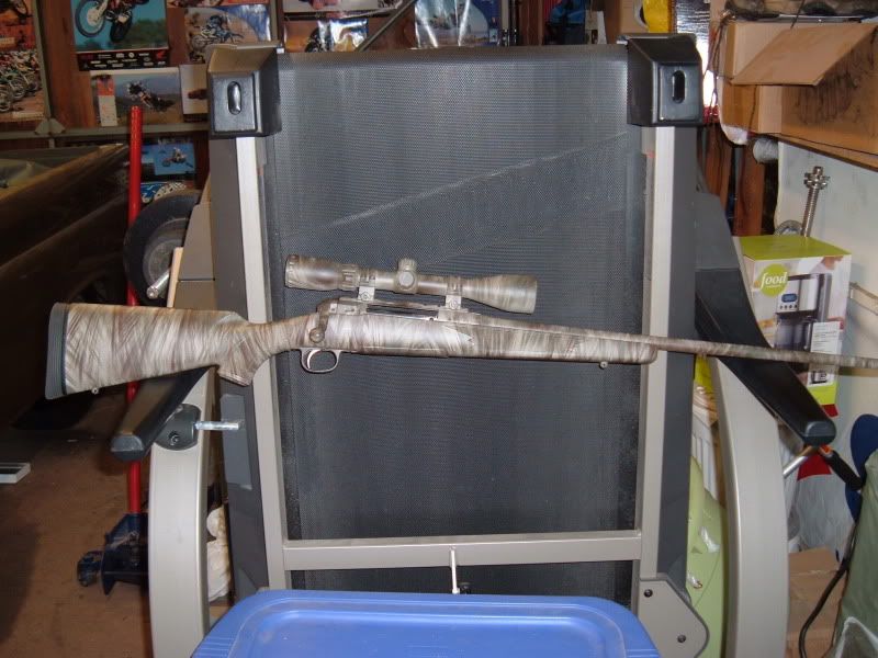

Here's a pic of a stevens 200 300 win mag. I use Krylon camo paint and straw from a broom to make the pattern.
Trailrider, that looks pretty nice. Clean & simple, not cluttery. Any prob's with the camo paint peeling off? I painted a syn. stock with regular spray paint and I could peel it off like a banana peel.
That's the problem I want to avoid too. Do you sand it lightly on the stock, just wipe it with IsoPropyl Alc, wipe with acetone, soap and water....what gets it to adhere best ? Is the Krylon the better paint? Rustoleum?

I've done a couple synthetic stocks and I'll I've done is wash them thoroughly with dish soap and rinse with very hot water. A pair of latex or rubber gloves helps keep your finger prints off as well.
I've never had a problem with the paint peeling or flaking and I've only used normal spray paint. The flatter the paint it will probably adhere better than the shinier stuff. You can also use a good clear coat if you want.
As I said earlier, the plastic-specific paint might be just the ticket. But I've had good luck with standard stuff.
If you want to experiment, practice, and build confidence, spray paint one of the plastic cases you have laying around like for a drill, socket set, whatever.
Having painted a couple rifles I think the best combination is using Krylon colors with duracoat clear coat. You get the ease of krylon with the durability of the duracoat. You can get the aerosol sprayer from your local autozone for $7 with the glass reservoir underneath the can.
