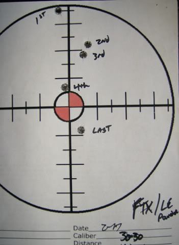

The first thing I do when I suspect an accuracy issue is pull back the yardage. Try shooting at 50yrds or even 25 if necessary.GJinNY said:I'll do another this Thursday at the 100 yd range. Target picture too.
Again, I was on a bench with rests and scoped.
