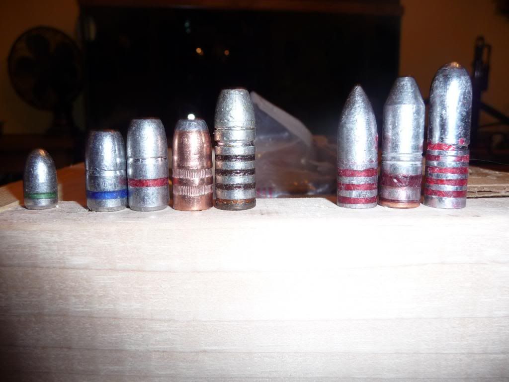

three on the right I use in my Sharps, 630gr LRN, 560gr LCNGC, 480gr spitzer
On the left are the bullets I use in my Marlins except the 9mm bullet, that one is in here for "perspective": 147gr 9mm, 350gr Dardas LRNFP, Meister 405gr LRNFP, Remington 405gr JSP, Meister 530gr LRNFPGC
Here's a pic:
