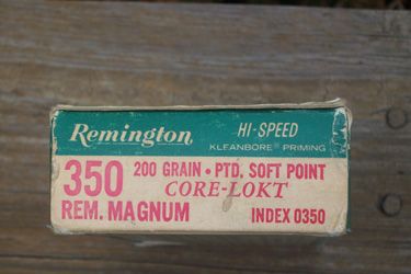

A buddy of mine hunts mule deer & coyotes with his old, original .350 Rem mag. When an uncle of his bought it back in the 1960's or 1970's, he got a case of 1,000 rounds of 200 grain soft point factory ammo. The gun now belongs to my buddy, and he's still working from that original case of ammo. His rifle has never had a scope on it. Makes big holes in mule deer and is way more than enough gun for coyotes...
