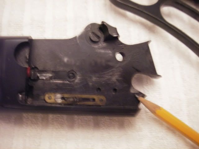

Ok now the big question as I was cleaning it and looking it over I noticed a real rough patch in the metal on the rear end of the barrel side of the reciever. This is located right above the half circle notch. Quick google found You Tube videos of someone taking one down and I could see the part that has broken off. It is the keeper for lack of a better term that goes under the bolt. Because I have never seen the inside of the gun personally until now I dont know if this provided both up and down and side to side suport for bolt. I can say that upon inspection from the exterior I had noticed that the rear of the bolt has alittle side to side movement but don't know if this is normal.

Will work on the pictures. The missing / broken off rear bolt guide as I am calling it is obviously my bigest concern. Have to learn how to post pictures to show the rest
Here is a picture of action showing where the peice is missing

Here is a pic of what should be there. I figure a good tig welder could weld a mound there and it could be filed in. Me, if it was cheap enough and you could point out the defect to the current owner for a little less cash outlay.

In looking, I believe the main function of the broken tab is to hold the bolt when you take the gun down. I do not think I would be too worried about it with the gun together. I would use it as a bargaining point to get the price down. I think about $100 off what you would give if it was undamaged would be a good deal. It will cost more than that to fix it. You would have to build it up file it down then reblue, as the welding would ruin the blue. Hope you can get a good deal on a shooter.
Thanks for the feed back , I too think that is the main purpose of the part and that is kind of what I was looking for as feedback. The main question I was wondering is what if you didn't fix it. When the gun is together it doen't appear that that part has a function. May be a stop for lever? As I dont have an intact one to compare to hard for me to figure. Would agree about waiting and spending 150 more to get a good one except I would be getting this one on trade so no money outlay. May even be able to work the deal alittle more.

It would take someone with more skills than myself to properly repare this part. Would at bear minimum take another gun to know exactly how part is to be shaped.
The only purpose of that missing triangular stud is to hold the bolt in place when the receiver is separated.
