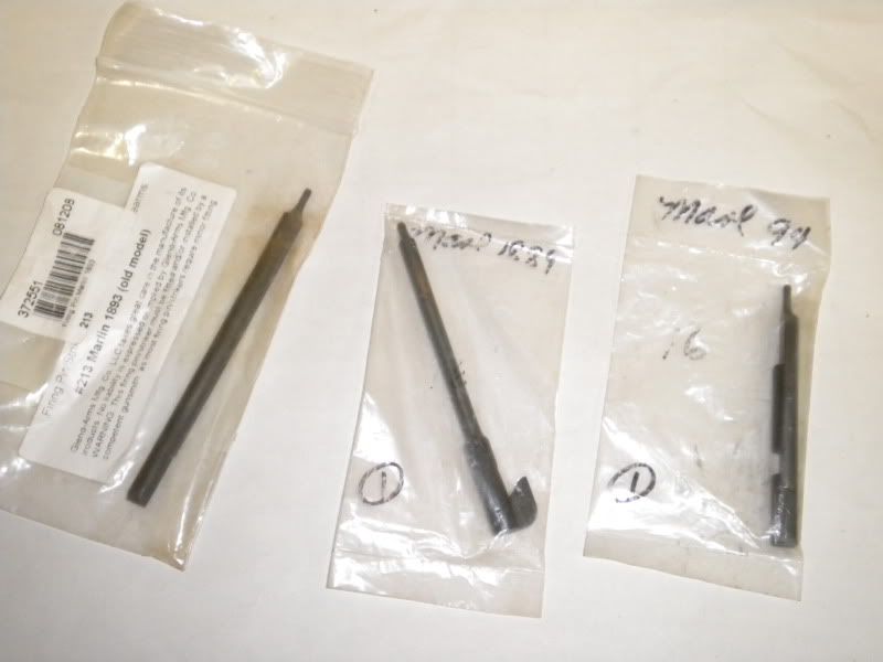

Pic of early Marlin firing pins.
Left to right 1893,1889,1894(front section of 2pc shown)These are Wisner replacements.
Antiques commonly break firing pins,but then they are very old.

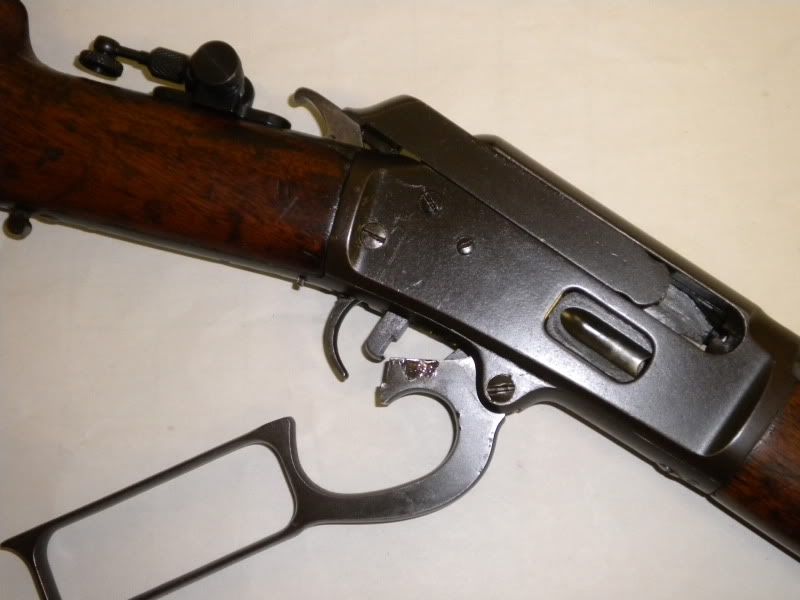

pics of 1889 model.Notice the differences in the lever/locking bolt,hammer spur,catch for the lever.
