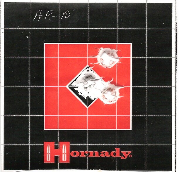

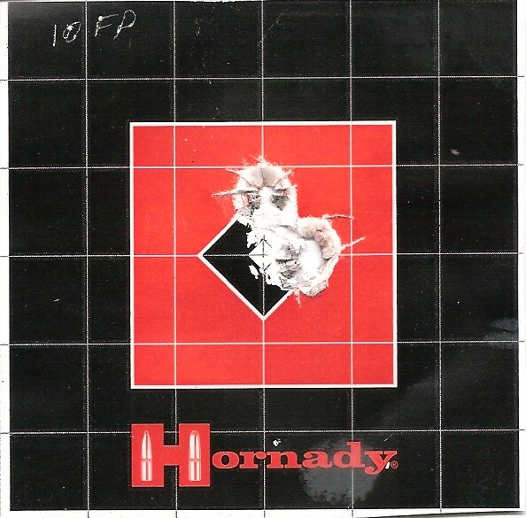

    I load 43.0 GR H4895 under a Hornady 165 GR SST in processed .mil LC cases.
    My Savage 10FP shoots them like this:
    My Armalite AR10 shoots them like this:

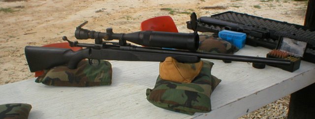

    Good results with Re15 in my Ruger M77 Mk II International. MOA accuracy at 100yds. 50.0gr and 130gr bullets at 3000fps. Also 45.0gr and 180gr bullets at 2600fps (as always, safe in my particular rifle only). I use a Redding neck sizing die, CCI 200 primers and Winchester brass.
    Shown here with a Bushnell Elite 3200 10x scope, and a Nikon Monarch 1.5x4.5 scope.
